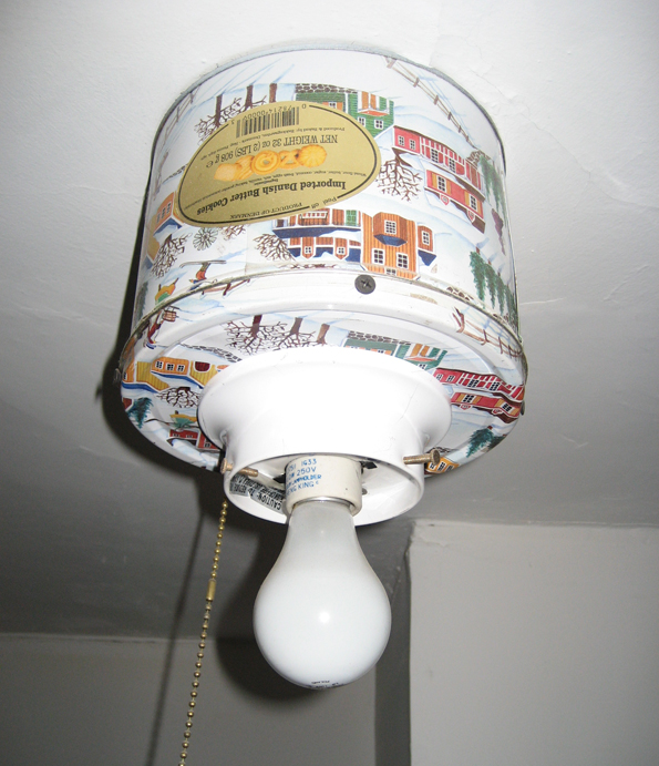

Hey, At Least It's Not a Fruitcake Tin
What better way to enjoy the holidays than with a tin full of cookies. Oops, I meant to say, a cookie-tin light fixture! This creative display was found by one of my former students while working in a customer’s home. While this may be creative, it is also a Code violation.
Luminaires and lampholders “shall be listed” in accordance with 410.6 of the NEC. I don’t think this was sent to a testing lab and approved to be listed. I also doubt that a field inspection was performed at this location.
It appears as though the installer did not want to deal with the old “BX” wiring found in the ceiling box, so instead of ripping out the old box and replacing wires, he simply cut out the bottom of the cookie tin and installed it as a type of extension or canopy over the existing box. How is the equipment grounding continuity maintained? This could pose a dangerous shock hazard if this metal is not bonded and grounded. This is a violation of 410.42.
There are also razor sharp edges and jagged metal present that could easily damage the conductor insulation. This is a violation of 410.56(B). Could the branch circuit wires overheat? They certainly could. This is a violation of 410.74.
I love cookies, especially around holiday time, but this may be one time that a fruit cake may have been the better choice — one that comes in a wrapper, not a tin can!
