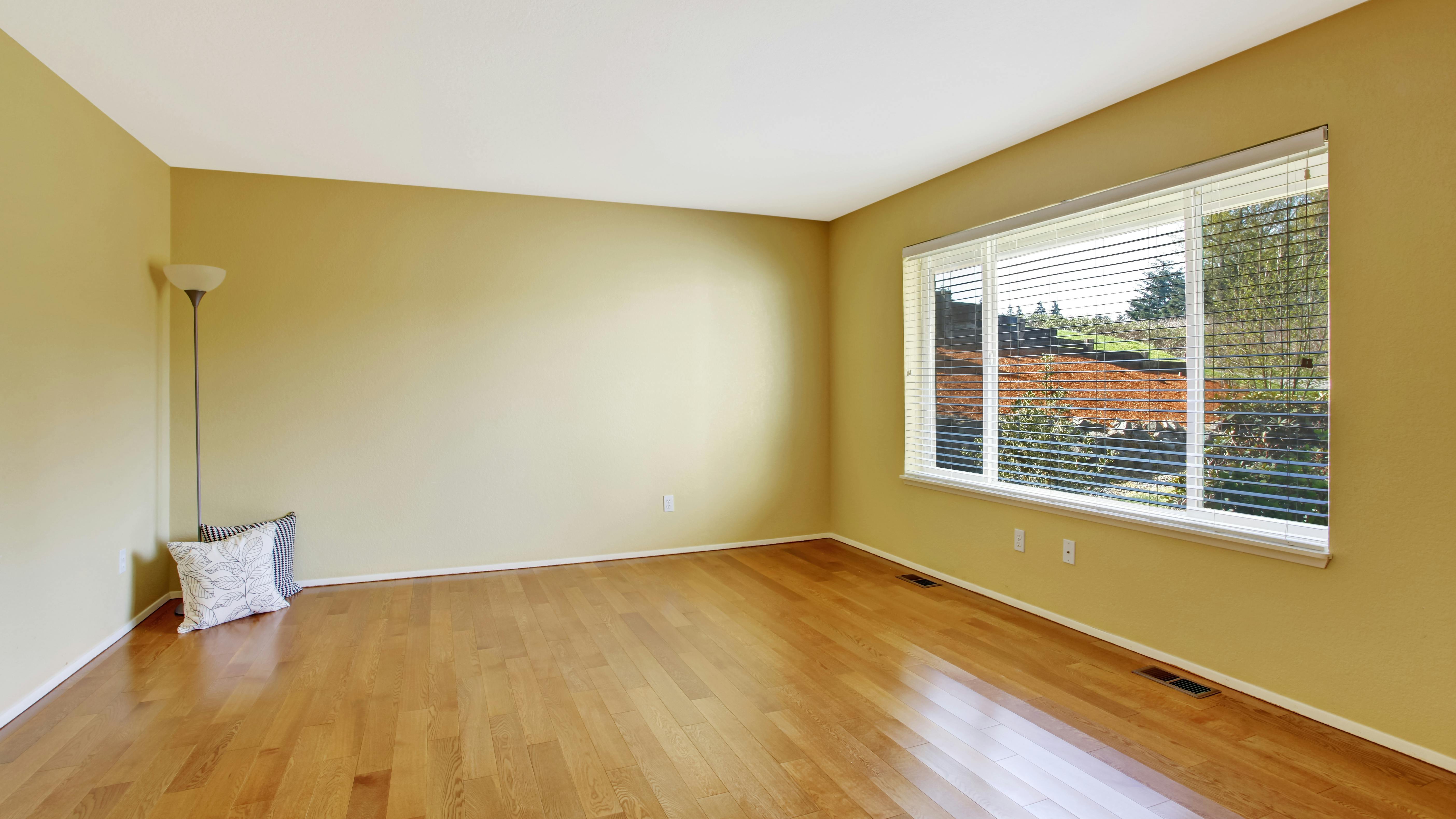

Q1: In a dwelling unit, any wall space, including space measured around corners and unbroken along the floor line by doorways, fireplaces, fixed cabinets, and similar openings, shall be considered wall space when the wall space is at least _______ wide.
a) 2 ft
b) 3 ft
c) 4 ft
d) 5 ft

Q1: a) 2 ft
 Per Sec. 210.52(A)(2)(1): "Any space 2 ft or more in width (including space measured around corners) and unbroken along the floor line by doorways and similar openings, fireplaces, stationary appliances, and fixed cabinets that do not have countertops or similar work surfaces" shall be considered wall space.
