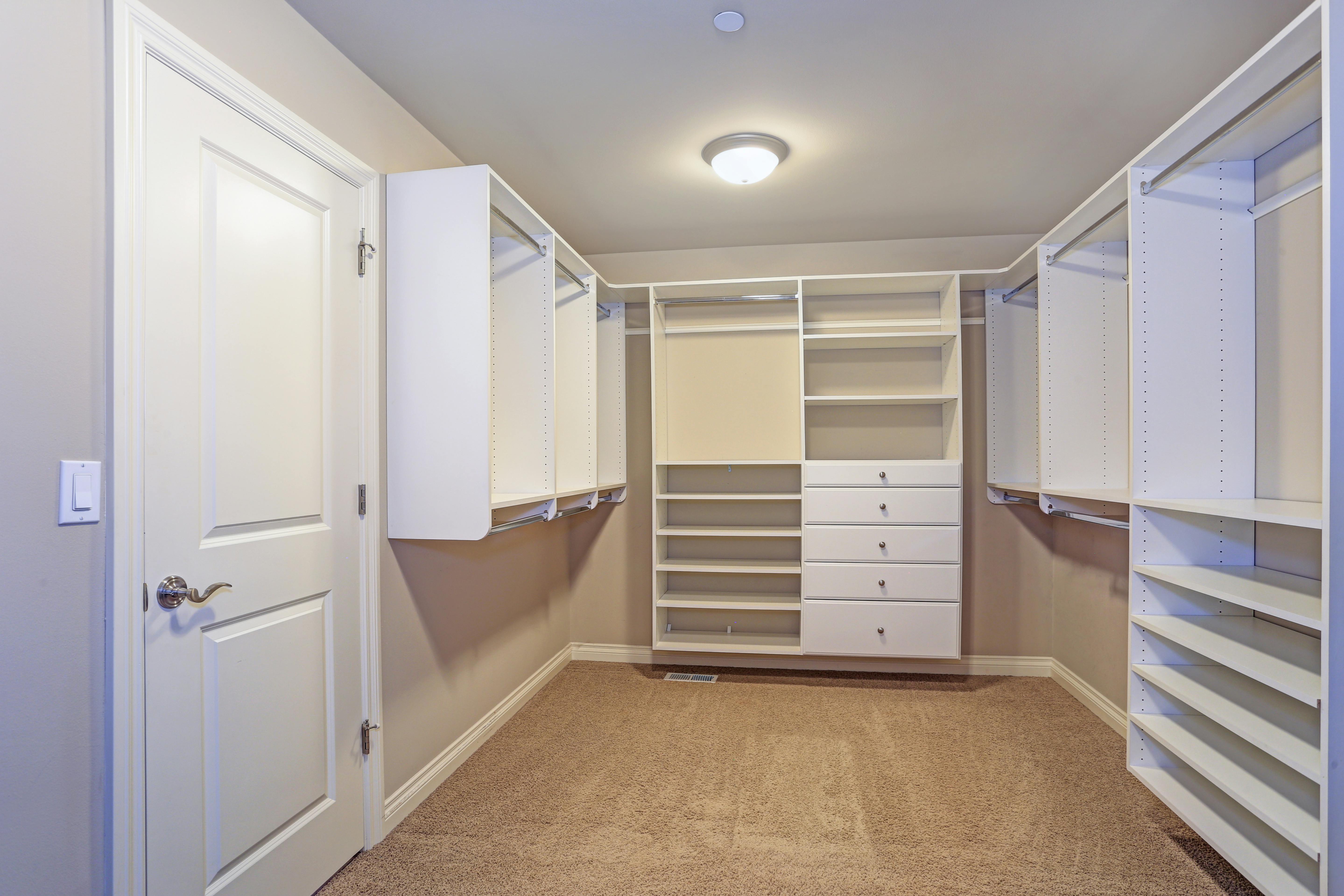

Q1: In clothes closet storage spaces, recessed incandescent or LED luminaires with a completely enclosed light source can be installed in the wall or the ceiling, provided there is a minimum clearance of _____ from the storage space.
a) 3 in.
b) 6 in.
c) 8 in.
d) 12 in.

Q1: b) 6 in.
Section 410.16(D)(3) requires, "6 in. for recessed incandescent or LED luminaires with a completely enclosed light source installed in the wall or the ceiling."
