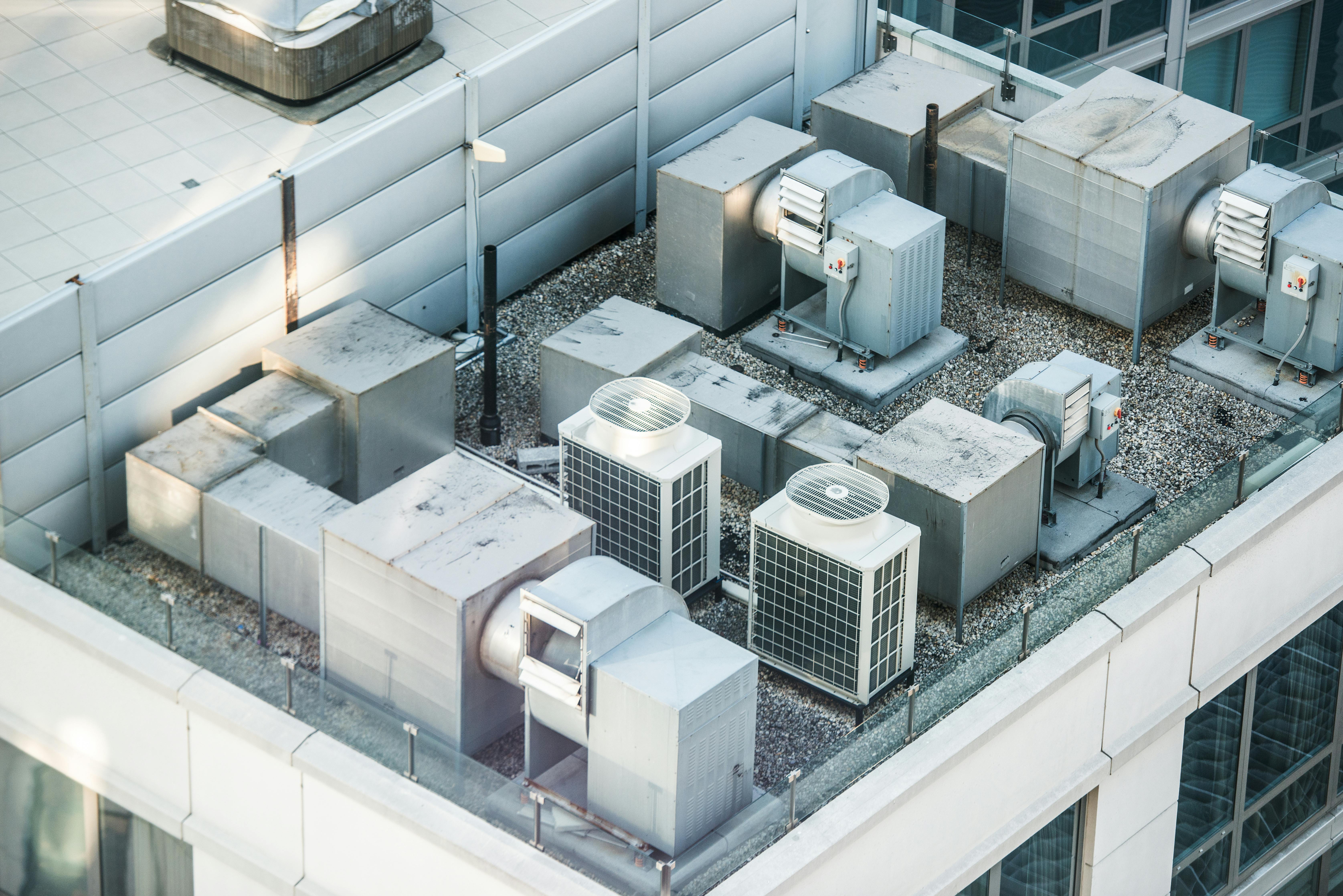

Q1: Where air-conditioning and refrigeration equipment is installed outdoors on a roof, a(an) _____ conductor of the wire type shall be installed in outdoor portions of metallic raceway systems that use compression-type fittings.
a) equipment grounding
b) grounding
c) equipment bonding
d) bonding

Q1: a) equipment grounding
Section 440.9 specifies, "Where equipment is installed outdoors on a roof, an equipment grounding conductor of the wire type shall be installed in outdoor portions of metallic raceway systems that use compression-type fittings."
