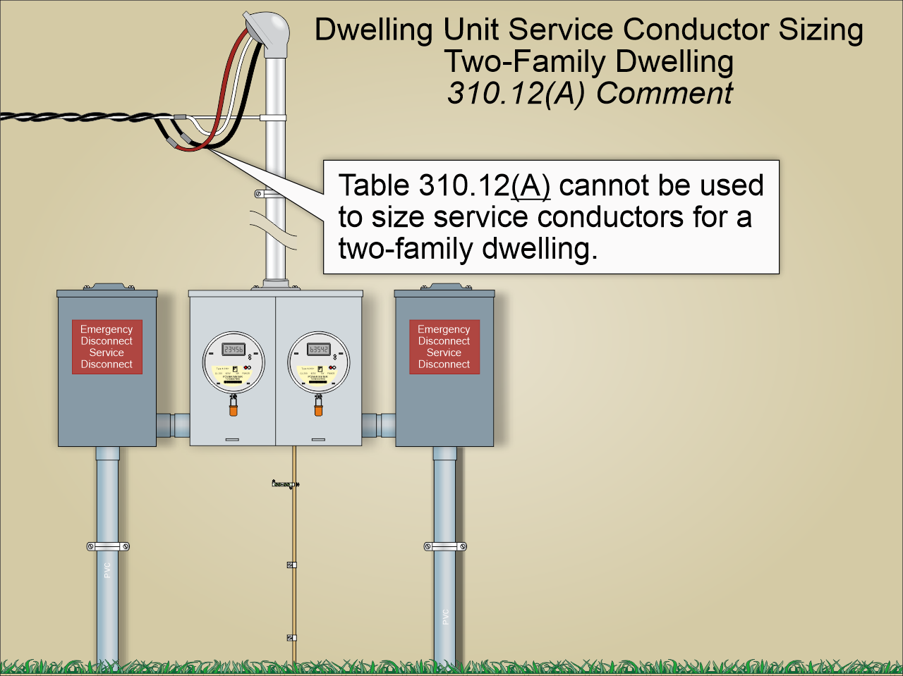

    (A) Services. Service conductors supplying the entire load associated with a one-family dwelling unit can be sized per Table 310.12(A) where there is no conductor ampacity adjustment or correction as required by Sec. 310.15.
    Table 310.12(A) cannot be used to size service conductors for two-family or multifamily dwelling buildings. (Fig. 1)

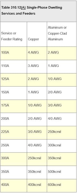

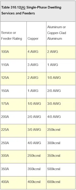

    (B) Feeders. Feeder conductors supplying the entire load associated with an individual dwelling unit can be sized per Table 310.12(A).
    (C) Feeder Conductors Not Greater Than Service Conductors. The feeder conductor ampacity for an individual dwelling unit is not required to be larger than the service conductor. (Fig. 2)
