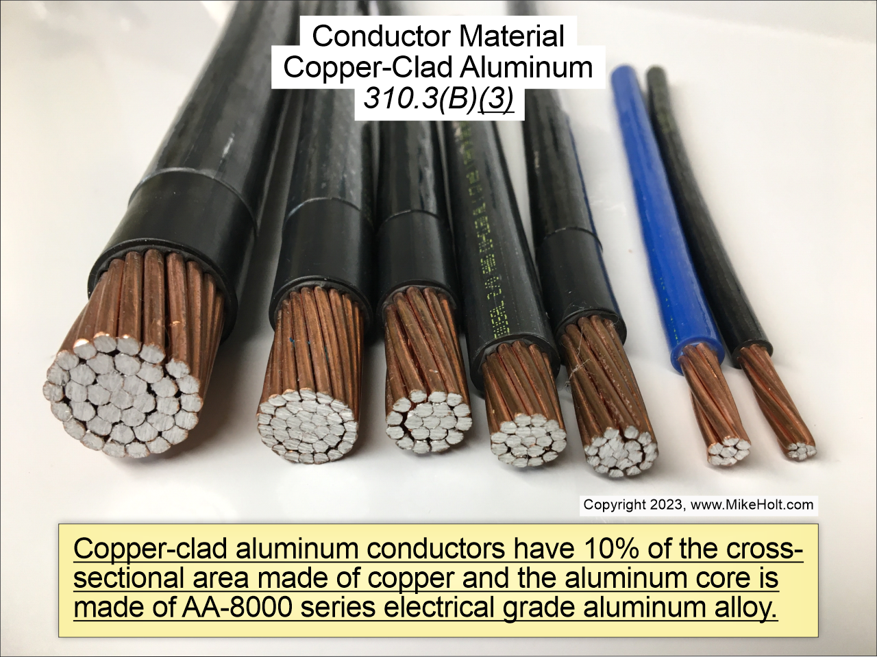

(3)  The copper of a copper-clad aluminum conductor only makes up 10% of the cross-sectional area. The aluminum core of a copper-clad aluminum conductor must be made of an AA-8000 series electrical grade aluminum alloy conductor material (Fig. 1). According to Art. 100, “Copper-Clad Aluminum Conductor” is drawn from a copper-clad aluminum rod with the copper metallurgically bonded to an aluminum core.
