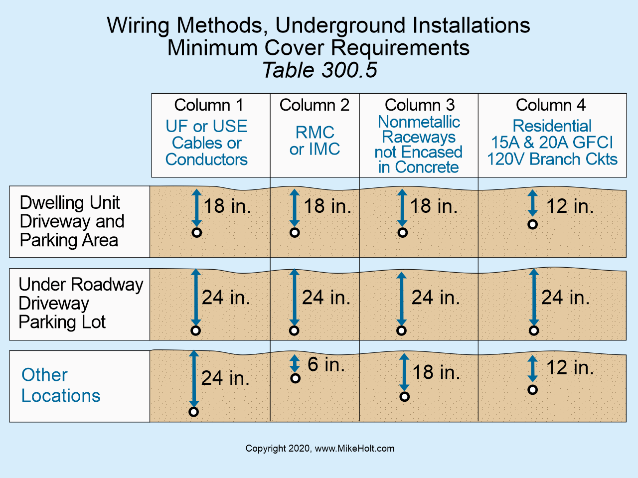

Q. What are the rules related to installing raceways and cables underground?
A. You can find these requirements in Sec. 300.5. Here’s a short recap for your review.
(A) Minimum Cover Requirements. When cables or raceways are installed underground, they must have a minimum cover per Table 300.5 (see Fig. 1 below).
