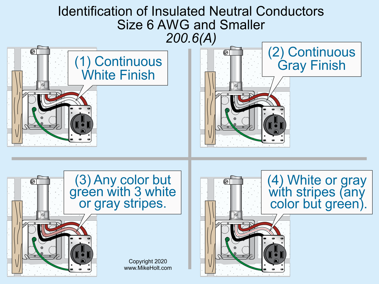

Q. What identification is required by the NEC for neutral conductors?
 See answer below.
A. Section 200.6 of the 2020 NEC outlines the identification requirements for grounded conductors.
200.6(A) 6 AWG or Smaller
Neutral conductors 6 AWG and smaller must be identified by any of the following means (Figure):
(1) Insulated conductors with a continuous white outer finish.
(2) Insulated conductors with a continuous gray outer finish.
(3) Insulated conductors with three continuous white or gray stripes along its entire length on other than green insulation.
(4) Insulated conductors with their outer covering finished to show a white or gray color but have colored tracer threads in the braid identifying the source of manufacture.
Author comment: The use of white tape, paint, or other methods of identification is not permitted for neutral conductors 6 AWG and smaller.
