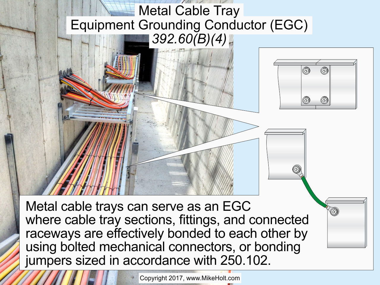

Q. Does the NEC allow a cable tray to be used as an equipment grounding conductor (EGC)?
A. Metal cable trays can be used as EGCs where continuous maintenance and supervision ensure that only qualified persons service the cable tray system [Sec. 392.60(A)]. Metal cable trays containing single conductors must be bonded together to ensure they have the capacity to conduct safely any fault current likely to be imposed in accordance with Sec. 250.96(A).Metal cable trays containing communications, data, and signaling conductors and cables must be electrically continuous through approved connections or the use of a bonding jumper. Metal cable trays can serve as EGCs where the following requirements have been met [Sec. 392.10(B) and (C)]:(1) Metal cable trays and fittings are identified as an EGC.(4) Cable tray sections, fittings, and connected raceways are effectively bonded to each other to ensure electrical continuity and the capacity to conduct safely any fault current likely to be imposed on them [Sec. 250.96(A)]. This is accomplished by using bolted mechanical connectors or bonding jumpers sized in accordance with Sec. 250.102 (Figure).
