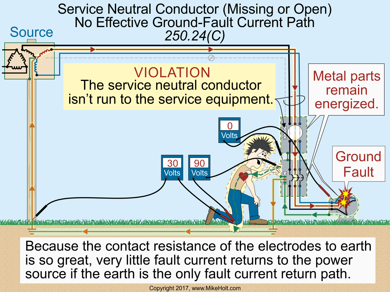

Q. The neutral of a grounded electric utility service must be installed and terminated at what location in accordance with the NEC?
A. A service neutral conductor must be run from the electric utility power supply with the ungrounded conductors and terminate to the service disconnect neutral terminal [Sec. 250.24(C)]. A main bonding jumper [Sec. 250.24(B)] must be installed between the service neutral terminal and the service disconnect enclosure [Sec. 250.28].
The service neutral conductor provides the effective ground-fault current path to the power supply to ensure that dangerous voltage from a ground fault will be quickly removed by opening the overcurrent protection device [Sec. 250.4(A)(3) and Sec. 250.4(A)(5)].
Even if the service equipment is only supplying loads with no neutral conductor, such as a 3-phase motor, a service neutral conductor between the electric utility and service is part of the effective ground-fault current path needed in case there is a ground fault condition (Figure).
DANGER: Dangerous voltage from a ground fault won’t be removed from metal parts, metal piping, and structural steel if the service disconnect enclosure isn’t connected to the service neutral conductor. This is because the contact resistance of a grounding electrode to the earth is so great that insufficient fault current returns to the power supply if the earth is the only fault current return path to open the circuit overcurrent protection device.
If the neutral conductor is opened, dangerous voltage will be present on metal parts under normal conditions, providing the potential for electric shock. If the earth’s ground resistance is 25 ohms and the load’s resistance is 25 ohms, then the voltage drop across each of these resistors will be half of the voltage source. Because the neutral is connected to the service disconnect, all metal parts will be elevated to 60V above the earth’s voltage for a 120/240V system.
