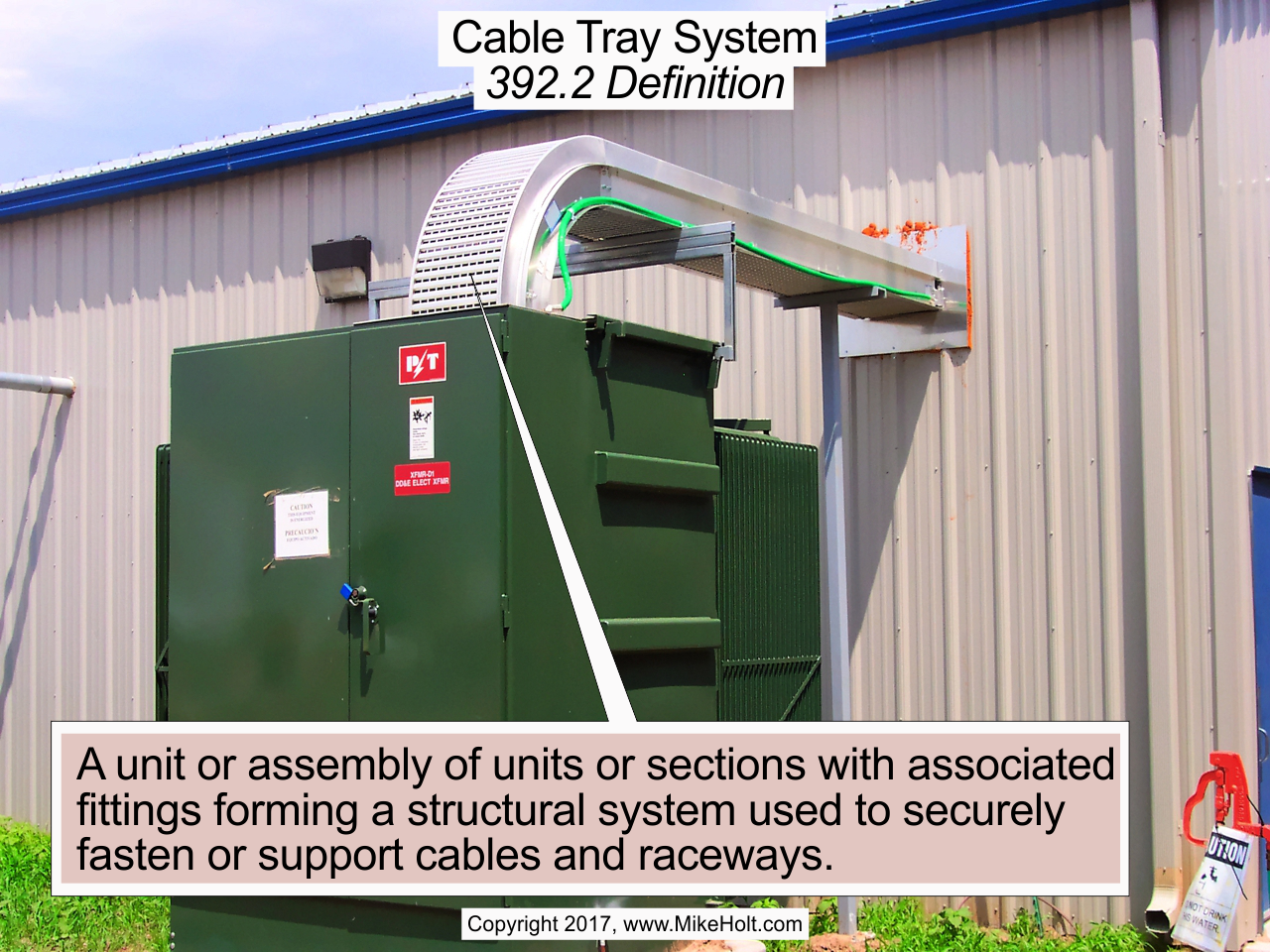

Q. How does the NEC define a cable tray system?
See the answer below.
A. A cable tray system is a unit or assembly of units or sections with associated fittings forming a rigid structural system used to securely fasten or support cables, raceways, and boxes [Sec. 392.2]. Cable tray isn’t a type of raceway. It’s a support system for cables and raceways.
