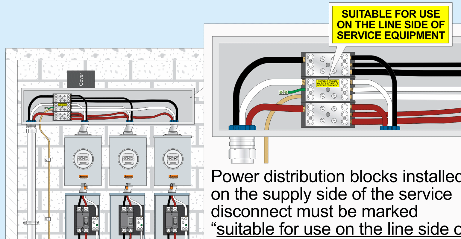

Q. What does the Code require when installing splices, taps, and power distribution blocks in a metal wireway?
A. Splices and taps in metal wireways must be accessible, and they must not fill the wireway to more than 75% of its cross‑sectional area [Sec. 376.56(A)].
The maximum number of conductors permitted in a metal wireway is limited to 20% of its cross‑sectional area at any point [Sec. 376.22(A)].
Power distribution blocks installed in wireways must be listed; if installed on the supply side of the service disconnect, they must be marked “suitable for use on the line side of service equipment” or equivalent [Sec. 376.56(B)(1)], as shown in the Figure.
In addition to the wiring space requirements [Sec. 376.56(A)], the power distribution block must be installed in a metal wireway not smaller than specified in the installation instructions of the power distribution block [Sec. 376.56(B)(2)].
Wire‑bending space at the terminals of power distribution blocks must comply with Sec. 312.6(B) [Sec. 376.56(B)(3)].
Power distribution blocks must not have uninsulated exposed live parts in the metal wireway after installation, whether or not the wireway cover is installed [Sec. 376.56(B)(4)].
Conductors must be installed so that the terminals of the power distribution block aren’t obstructed [Sec. 376.56(B)(5)].
