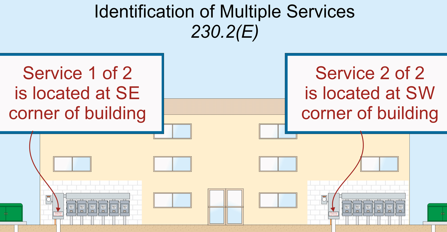

(E) Identification of Multiple Services. If a building is supplied by more than one service, or a combination of feeders and services, a permanent plaque or directory must be installed at each service and feeder disconnecting means location to denote all other services and feeders supplying that building, and the area served by each (see Figure).
