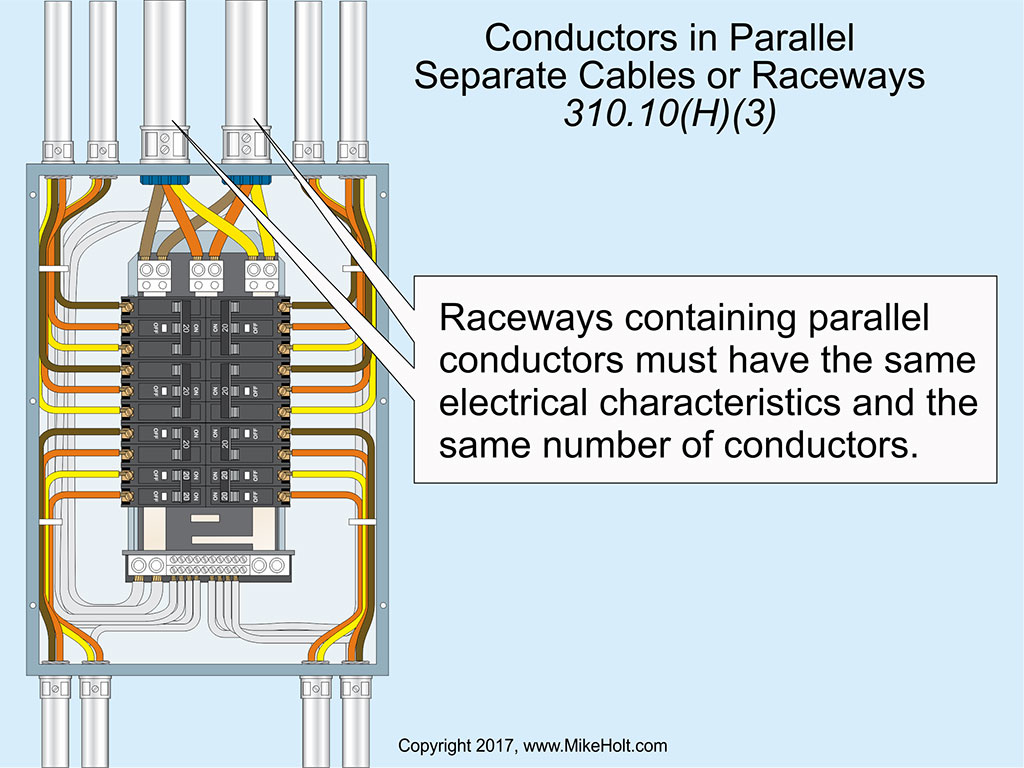

NEC requirements for conductors installed in parallel
Q. What does the Code require for separate raceways or cables that contain parallel conductors?
Scroll down to see the answer
This answer is based on the 2017 NEC.
A. Separate raceways or cables containing parallel conductors must have the same electrical characteristics [310.10(H)(3)], as shown in the Figure.
If one set of parallel conductors is installed in a metal raceway and the other conductors are installed in PVC conduit, the conductors in the metal raceway will have an increased opposition to current flow (impedance) as compared to the conductors in the nonmetallic raceway. This results in an unbalanced distribution of current between the parallel conductors.
Parallel conductor sets must have all circuit conductors within the same raceway [Sec. 300.3(B)(1)].
