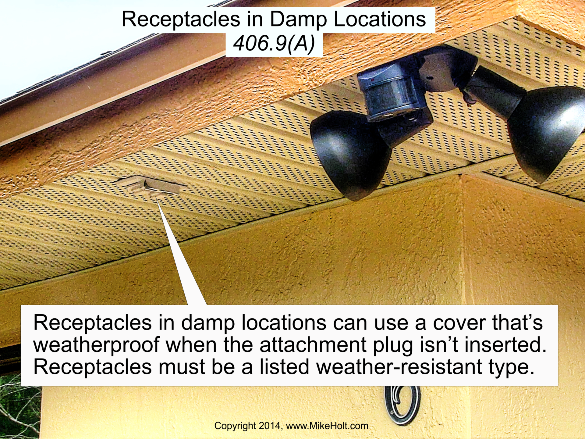

Q. What are the Code rules for installing receptacles in damp or wet locations?
Find the Answer
A. Receptacles installed in a damp location must be installed in an enclosure that’s weatherproof when an attachment plug cap isn’t inserted, and the receptacle cover is closed, or an enclosure that’s weatherproof when an attachment plug is inserted. All nonlocking 15A and 20A, 125V and 250V receptacles in a damp location must be listed as weather resistant [406.9(A)] (see Figure).
Damp locations include locations protected from weather and not subject to saturation with water or other liquids, as well as locations partially protected under canopies, marquees, roofed open porches, and interior locations that are subject to moderate degrees of moisture, such as some basements, barns, and cold-storage warehouses [Art. 100].
