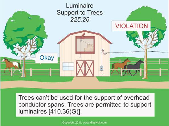

Q. Does the NEC allow the use of trees to support overhead feeder or branch circuit conductors?
A. Trees or other vegetation must not be used for the support of overhead conductor spans. This applies to both feeders and branch circuits [225.26]. Section 410.36(G) does allow trees to be used for the support of luminaires, as shown in Fig. 2.
Fig. 2. Trees can be used to support luminaires.
Service-drop conductors installed by the electric utility must comply with the rules of the National Electrical Safety Code (NESC), not the National Electrical Code [90.2(B)(5)]. Overhead service conductors that aren’t under the exclusive control of the electric utility must be installed in accordance with the NEC.
