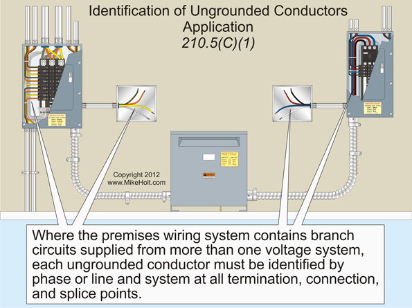

Figure. Marking can be done by permanently posting an identification legend that describes the method used, such as color-coded marking tape or color-coded insulation.

Ungrounded conductors must be identified as follows [210.5(C)]:
• If the premises wiring system contains branch circuits supplied from more than one voltage system, each ungrounded conductor must be identified by phase and system at all termination, connection, and splice points.
• Identification can be by color coding, marking tape, tagging, or other means approved by the authority having jurisdiction.
• The method of identification must be documented in a manner that's readily available or permanently posted at each branch-circuit panelboard.
When a premises has more than one voltage system supplying branch circuits, the ungrounded conductors must be identified by phase and system. This can be done by permanently posting an identification legend that describes the method used, such as color-coded marking tape or color-coded insulation, as shown in the Figure.
