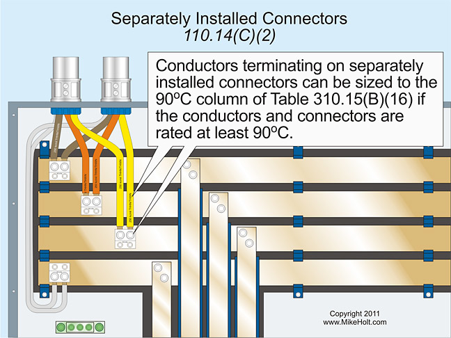

(b) Equipment rated more than 100A must be sized using these rules:
  • Conductors must be sized using the 75°C temperature column of Table 310.15(B)(16).
  • Separate connector provisions. Conductors can be sized to the 90°C column of Table 310.15(B)(16) if the conductors and pressure connectors are rated at least 90°C, as shown in Fig. 1.
