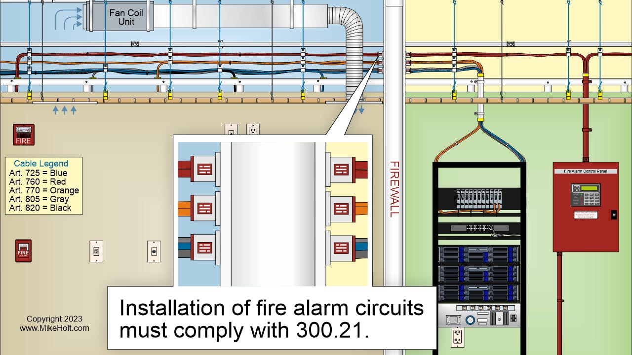

(A) Installation of fire alarm circuits must comply with Sec. 300.21 (Fig. 1).
