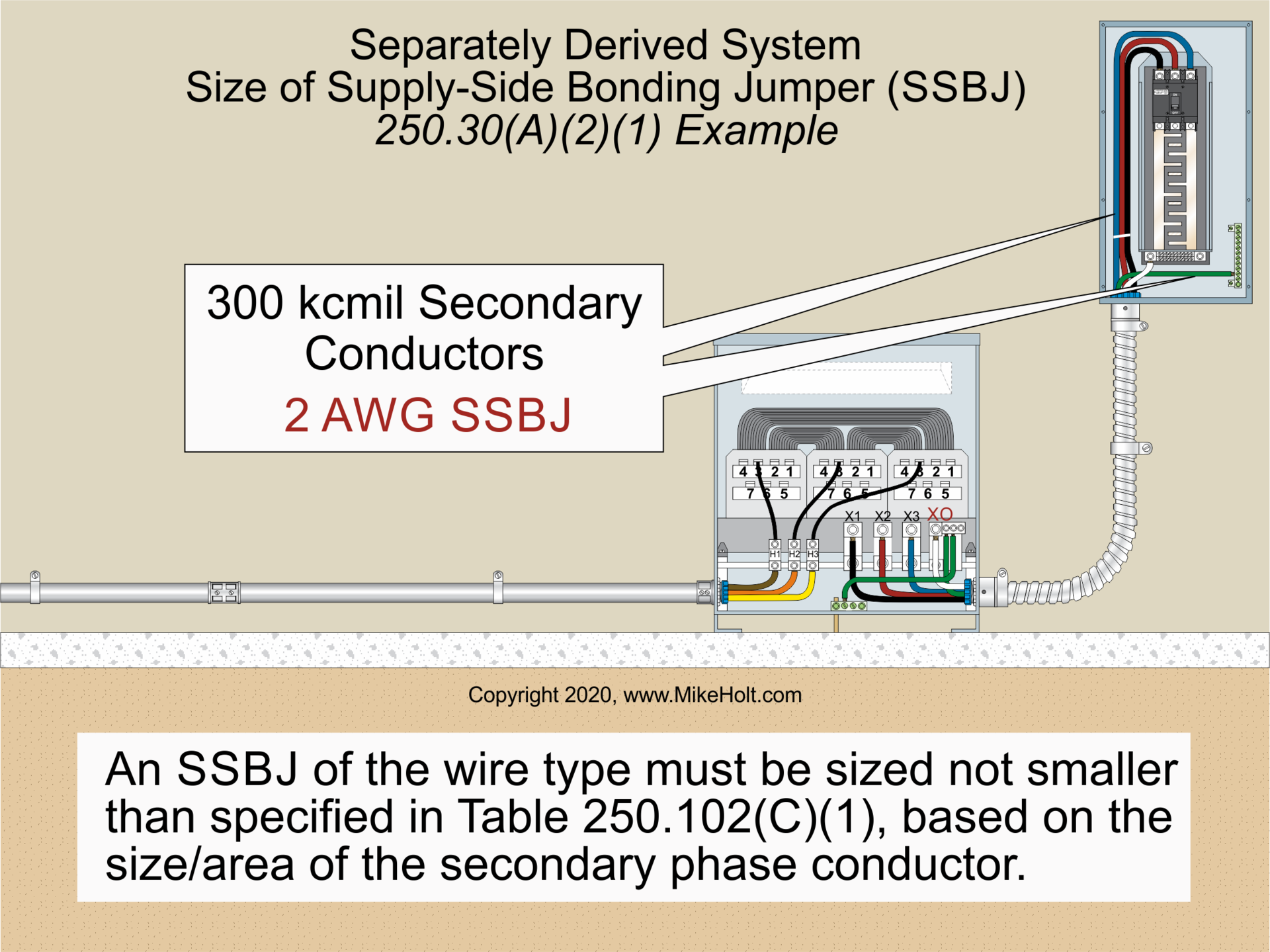

If the SDS is indoors, you must install the required system bonding jumper at the secondary neutral terminal of the SDS or at the first system disconnect [Sec. 250.30(A)(1)(a)] and size it per Table 250.102(C)(1), based on the area of the secondary phase conductor.
SDS supply-side bonding jumper
You must run a supply-side bonding jumper from the SDS  equipment grounding conductor terminal to the equipment grounding conductor terminal on the secondary system disconnect enclosure and size it per Table 250.102(C)(1), based on the area of the secondary phase conductor [250.30(A)(1)].
Example question: What size supply-side bonding jumper is required for flexible metal conduit containing 300kcmil secondary conductors (Fig. 1)?
Answer: 2 AWG, based on the 300kcmil conductors [Table 250.102(C)(1)]
When the system bonding jumper is installed at a secondary system disconnect, a secondary neutral conductor in each raceway, sized no smaller than specified in Table 250.102(C)(1), must be run from the SDS secondary to the disconnect enclosure of the secondary system.
Example question: What size neutral conductor is required for a 112.50kVA transformer paralleled in two raceways with 3/0 AWG secondary conductors in each raceway?
Answer: 1/0 AWG
Table 250.102(C)(1) requires a minimum of a 2 AWG neutral conductor based on the equivalent size of two 3/0 AWG conductors (167,800cmil × 2 conductors = 335,600cmil), but the minimum size neutral conductor in parallel is 1/0 AWG [Sec. 310.10(G)(1)].
Ensure that the 1/0 AWG conductor is large enough to handle the maximum unbalanced load [Sec. 220.61]. When a system bonding jumper is installed at the secondary system disconnect, the secondary neutral conductor will serve as part of the effective ground-fault current path.
