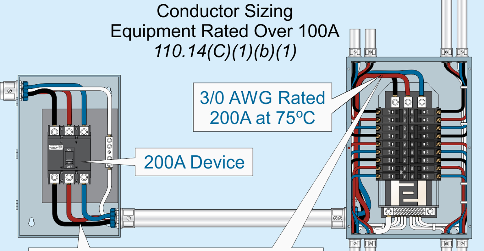

For equipment rated greater than 100A, size the conductor per the ampacities in the 75°C temperature column of Table 310.16 [Sec. 110.14(C)(1)(b)(1)] (Fig. 2). Splicing and terminating devices with terminals rated 90°C and not connected to electrical equipment can have their conductors sized per the ampacities in the 90°C temperature column of Table 310.16 [Sec. 110.14(C)(2)].
 Fig. 2. For equipment rated over 100A, size the conductor per the ampacities in the 75°C temperature column of Table 310.16.
