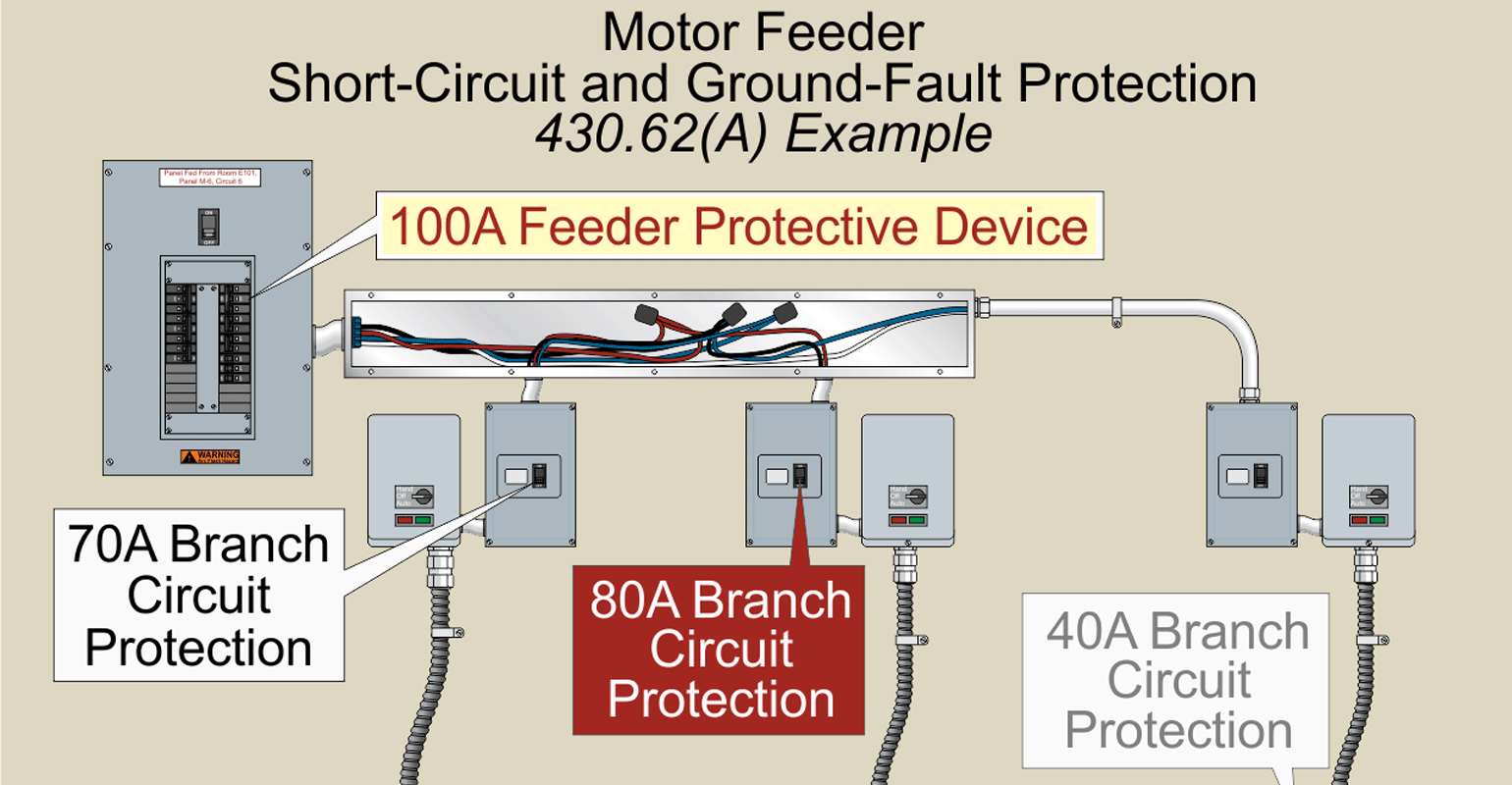

Example: What size inverse-time circuit breaker is required for feeder protection required for the following motors? All motors branch circuits have inverse-time circuit breakers (Fig. 2).
Motor 1: 7½-hp, 208V, 3-phase: FLC = 24.20A [Table 430.250]
Motor 2: 5-hp, 208V, single-phase: FLC = 30.80A [Table 430.248]
Motor 3: 1 hp, 115V, single-phase: FLC = 16A [Table 430.248]
Size your feeder protection [Sec. 430.62(A)] no greater than the largest branch-circuit ground-fault and short-circuit overcurrent device plus the other motors’ FLC in the same group.
Step 1: Determine the largest branch-circuit ground-fault and short-circuit overcurrent protection device [Sec. 430.52(C)(1) Exception].
7½-hp motor = 24.20A × 2.50 = 60.50, round up to 70A
5-hp motor = 30.80A × 2.50 = 77A, round up to 80A
1-hp motor = 16A × 2.50 = 40A
Step 2: Determine the size of the feeder protection device based on the largest group of motors. To determine the group, you need to balance out the motors between L1, L2, and L3 (Fig. 3).
Not more than 80A + 24.20A = 104.20A,
Next size down = 100A [Sec. 240.6(A)]
The “next-size-up protection” rule for branch circuits [Sec. 430.52(C)(1) Ex 1] doesn’t apply to the motor feeder overcurrent protection device rating.
