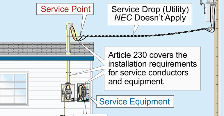

Article 230 covers the installation requirements for service conductors and service equipment (Fig. 1). To know when the requirements of Art. 230 apply, you need to understand three critical definitions.
1. Service point. The point of connection between the serving electric utility and the premises wiring.
2. Service conductors. The conductors from the service point to the service disconnecting means. Service-entrance conductors can either be overhead or underground.
3. Service equipment. The necessary equipment, usually consisting of circuit breakers or switches and fuses and their accessories, connected to the load end of service conductors at a building or other structure, and intended to constitute the main control and cutoff of the electrical supply. Service equipment doesn’t include individual meter socket enclosures [Sec. 230.66].
From these definitions, you can see that service conductors originate at the serving electric utility (service point) and terminate on the line side of the service disconnect. The electric utility typically determines where the service point is located. The service point determines where the NEC requirements begin
(Fig. 2).
