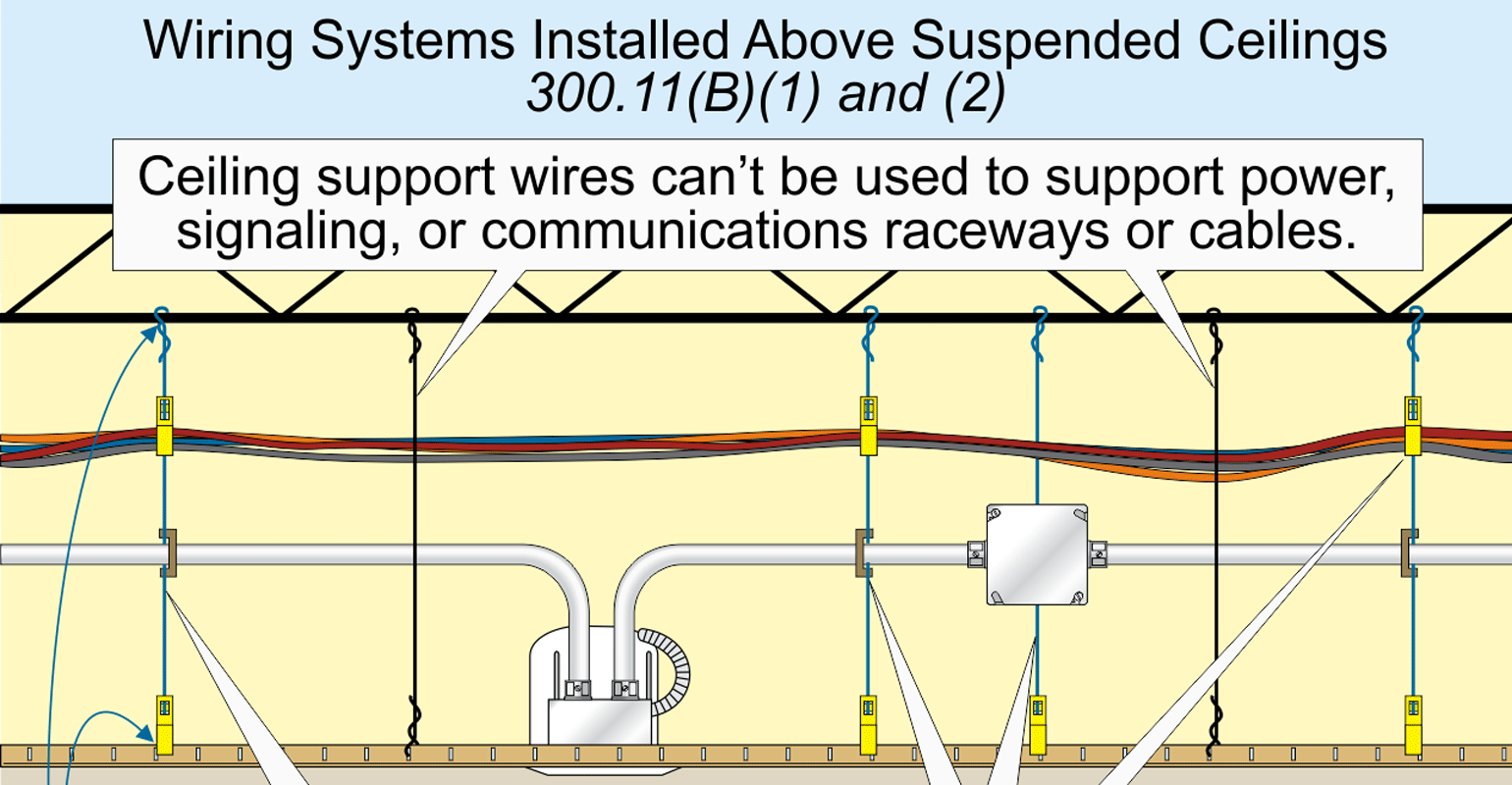

Mechanical execution
Fire alarm circuits must be done in a neat and workmanlike manner [Sec. 760.24(A)].
This includes supporting:
• Exposed cables by the building’s structural components so the cable won’t be damaged by normal use.
• Cables by straps, staples, hangers, cable ties, or similar fittings designed and installed in a manner that won’t damage the cable.
• Raceways/cables above a suspended ceiling by independent support wires attached to that ceiling [Sec. 300.11(B), Sec. 760.46, and Sec. 760.130] (Fig. 1).
