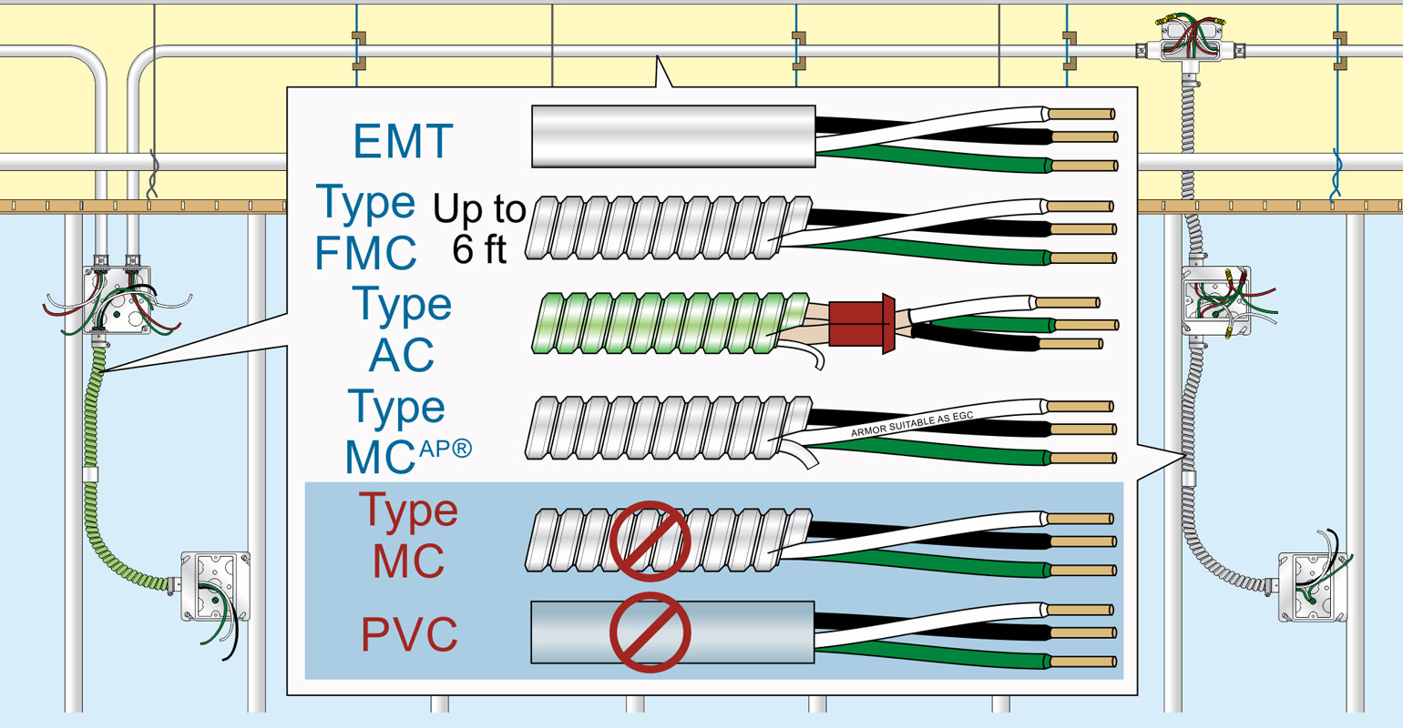

Branch-circuit conductors serving patient care spaces must be contained in a metal raceway or cable having a metal sheath that qualifies as an equipment grounding conductor (EGC) per Sec. 250.118 [517.13(A)] (Fig. 1). The metal sheath of traditional Type MC interlock cable isn’t identified as an EGC [250.118(10)(a)]; therefore, you can’t use this wiring method for circuits in patient care spaces. The metal sheath of Type AC cable is identified as an EGC in 250.118(8) because it contains an internal bonding strip that’s in direct contact with the metal sheath of the interlock cable. The same goes for Type MCAP cable.
