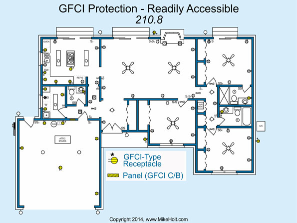

Fig. 1. GFCI devices required by Sec. 210.8(A) through (D) must be installed in readily accessible locations.
GFCIs
A GFCI device must be installed (Fig. 1) in the places named in Sec. 210.8(A) through (D). These include both dwelling units and other than dwelling units.
GFCI protection at dwelling units is required for all 15A and 20A, 125V receptacles installed in:
1) Bathroom areas.
2) Garages and accessory buildings. This includes grade-level portions of accessory buildings used for storage or work areas of a dwelling unit. If you install a 15A or 20A, 125V receptacle in an accessory building, it must be GFCI protected.
3) Outdoors. This includes all receptacles outside a dwelling unit. Each unit of a multifamily dwelling with individual entrances at grade level must have at least one GFCI-protected receptacle accessible from grade level and not more than 6½ ft above grade [210.52(E)(2)]. Attached balconies, decks, and porches accessible from inside the unit must each have at least one GFCI-protected receptacle [210.52(E)(3)].
4) Crawl spaces. The NEC requires a receptacle in a crawl space only if it contains heating, air-conditioning, and refrigeration equipment [210.63].
5) Unfinished basements. These are the unfinished portion(s) not intended as a habitable room and limited to storage and work areas. Excluded are receptacles supplying only permanently installed fire alarm or burglar alarm systems [760.41(B) and 760.121(B)].
6) Kitchen countertop surfaces
7) Sinks. This includes only receptacles within an arc measurement of 6 ft from the outside edge of a sink.
8) Boathouses. If you install a 15A or 20A, 125V receptacle in a boathouse, it must be GFCI protected.
9) Bathtubs or shower stalls. This includes only receptacles within 6 ft of the outside edge of a bathtub or shower stall.
10) Laundry areas.
Fig. 2. All 15A and 20A, 125V receptacles located in a kitchen must be GFCI protected.
