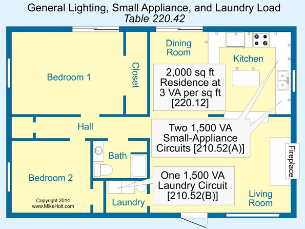

Step 1: The NEC recognizes that general lighting and receptacle, small-appliance, and laundry circuits won’t all operate at full load at the same time. So you can apply a demand factor to the total connected load [220.52] (Fig. 1).
Fig. 1. Because the NEC recognizes that general lighting and receptacle, small-appliance, and laundry circuits won’t all operate at full load at the same time, you can apply a demand factor to the total connected load.
Determine the total connected load for:
  1. General lighting and receptacles at 3VA per sq ft [220.12],
  2. Two small-appliance circuits each at 1,500VA [220.52(A)], and
  3. One laundry circuit at 1,500VA [220.52(B)].
Next, apply the Table 220.42 demand factors to the total connected load. Since this is a dwelling unit, the first 3,000VA is applied at 100% demand and the remaining VA at 35% demand.

The NEC recognizes that the general lighting and receptacle, small-appliance, and laundry circuits won’t be operating at full load at the same time. So it allows you to apply a demand factor to the total connected load [220.52] (Fig. 1). To determine the feeder demand load for these circuits, use three steps:
Step 1: Determine the total connected load for:
Step 2: Apply the Table 220.42 demand factors to the total connected load.
Step 3: First 3,000VA at 100% demand; remaining VA at 35% demand.
The NEC requires a minimum of 3VA per sq ft for general lighting and general-use receptacles when doing branch circuit and feeder/service calculations. When determining the area, use the outside dimensions of the building; don’t include open porches, garages, or spaces not adaptable for future use (Fig. 4).
Fig. 4. The area is based on the outside dimensions of the building. Don’t include open porches, garages, or spaces not adaptable for future use.
The 3VA per sq ft rule for general lighting includes all 15A and 20A general-use receptacles, but it doesn’t include the small-appliance or laundry circuit receptacles. See Sec. 220.14(J) for details.
