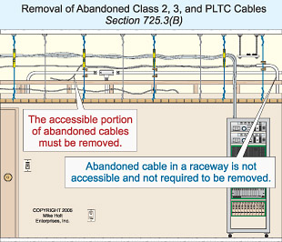

What about abandoned cable? To limit the spread of fire or products of combustion within a building, you must remove the accessible portion of cable that isn't terminated at equipment or identified for future use with a tag [725.2] (Fig. 1 on page 56).
This rule doesn't require removing concealed cables that are abandoned in place. By definition (Art. 100), cables in raceways are concealed. Thus, you don't have to remove cables that are in raceways.
