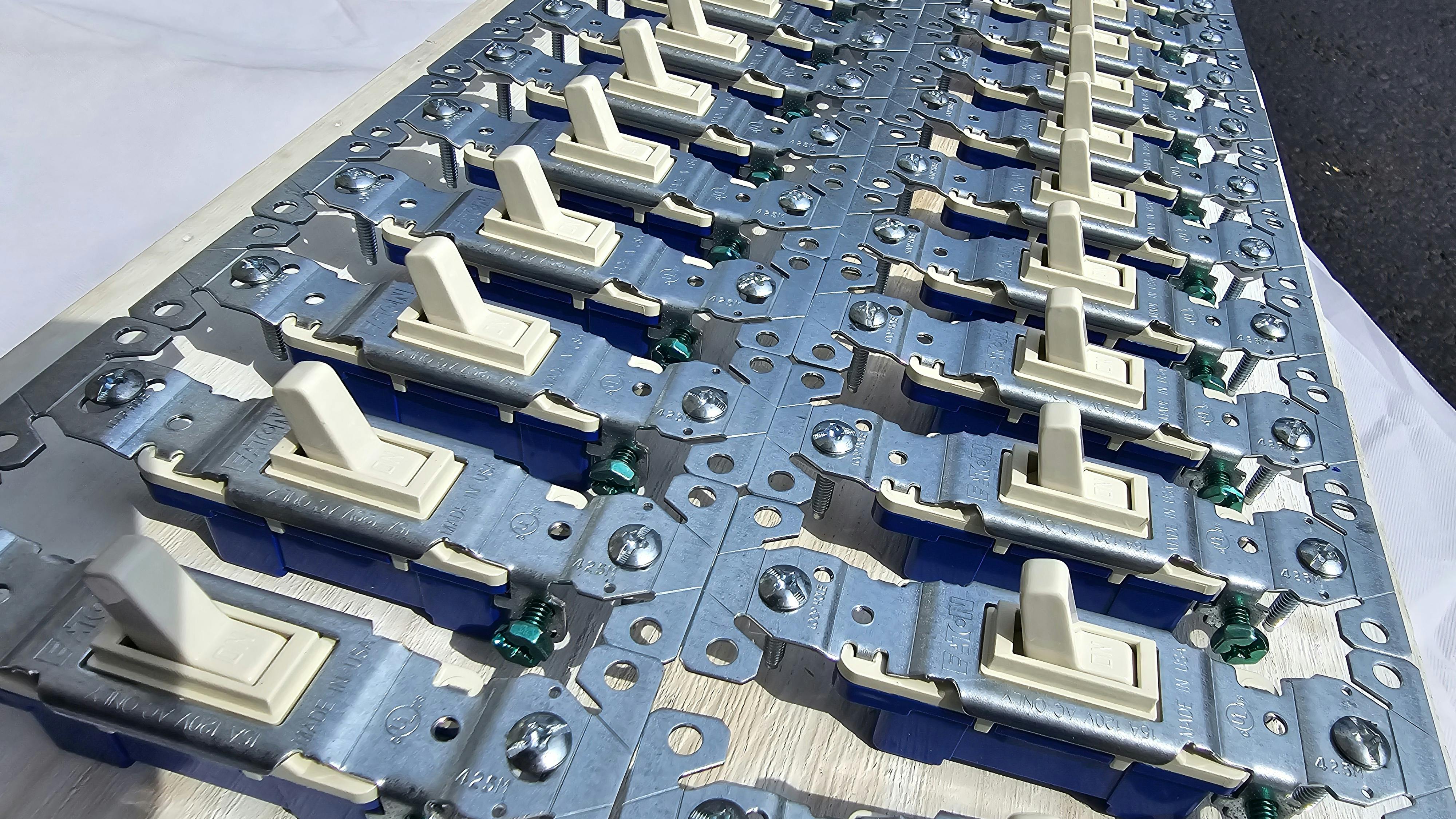

Electrical switches are essential to operating and controlling motors, luminaires, and appliances used daily in residential, commercial, and industrial applications. The “flush-mounted switch” was patented on July 17, 1917 by William J. Newton from Lynbrook, N.Y. — 20 years after the first publication of the NEC. Article 404 covers the provisions for selecting, replacing, and installing “General Use” switching devices and circuit breakers (toggle and knife switches) used to connect or disconnect the conducting path in an electrical circuit operating at 1,000V and below unless specifically referenced elsewhere in the NEC for higher voltages.
As an electrical apprentice, it’s critical to understand all facets of the Code. Although switches are obviously a simple device, the NEC guidelines may not be quite as straightforward as you might think, depending on the application. So let’s take a look at what applying the Code requirements in this area entails.

  • Surface or flush-mounted switches
  • Switches installed in damp and wet locations
  • Switches used to control loads from single or multiple locations
  • Basic electrical switches (e.g., snap, toggle type, timer, and rocker switches)
  • Sophisticated switches (e.g., smart electronic switches, occupancy sensors, and wireless remote switches)
