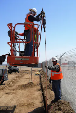

    Section 250.53(A) requires rod and pipe electrodes to be installed in contact with the soil at least 2.44 m (8 ft). They are to be driven vertically unless a rock bottom is encountered. If rock bottom is encountered that prevents the rod from being driven 8 ft vertically, it is permitted to be installed at an oblique angle of not more than 45º from vertical. Where a rock bottom is encountered at an angle up to 45º, which prevent the rod from being installed, only then can the rod or pipe be buried in a trench that is at least 750 mm (30 in.) deep, as seen in Fig. 3
    The upper end of the rod is to be flush with or below ground level unless the aboveground end of the rod, and the grounding electrode conductor attachment is protected from physical damage. This will require that a ground rod longer than 8 ft be used if any part of the rod is exposed above ground level. Since an 8-ft ground rod or pipe must be driven the entire length, the ground clamp is required to be listed for direct earth burial.

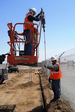

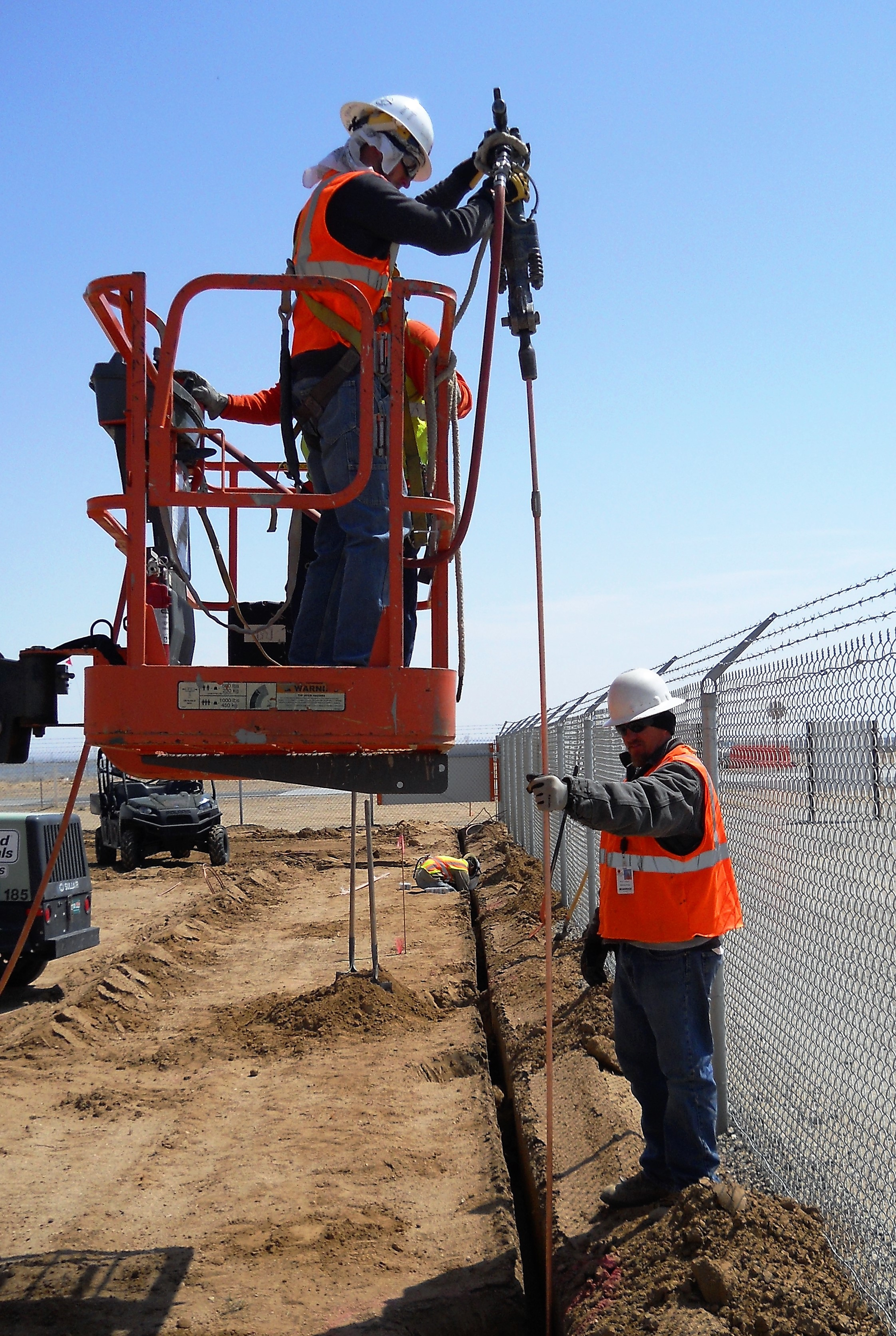

    As can be seen by the intro photo, driving ground rods can be difficult work depending on what part of the country you are located in. Installation of these components of a grounding system needs to be done correctly and in compliance with the NEC. The safety of the building or structure depends on you.
