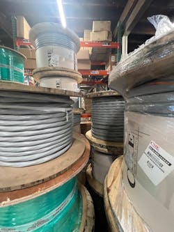

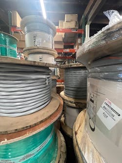

One of the most essential Chapter 3 wiring methods for residential electricians in the National Electrical Code (NEC) is service entrance (SE) cable. Its primary purpose is to be used as a “main” feeder for the (building or premises) aerial service drop or underground feeder connection to dwelling units. This cable transports power from the utility company to the line side of the meter base — and then from the load side of the meter base to the breaker box or panelboard. It can be used in aerial (aboveground installations) as well as underground installations (if marked with SEU). Article 338 covers the use, installation, and construction specifications for SE cable, which is available as a single conductor or multiconductor assembly “with or without” an overall non-metallic sheathed covering.

Service entrance cable Type SE is available as style SER and SE style U. Available in copper and aluminum, it's rated up to 600V, and the insulated (individual) conductors are covered with XHHW-2 or THHN/THWN. The gray jacketed-style cable has a flame-retardant, sunlight- and moisture-resistant polyvinyl chloride (PVC) outer jacket. In addition, a thin plastic reinforcement tape is wrapped around the conductors for added strength and conformity.
Type SEU cable has two insulated phase conductors surrounded by a concentric neutral. Type SER has three insulated conductors with an uninsulated grounding conductor. Type USE service-entrance cable is designed for underground use; it has a moisture-resistant covering but may not have a flame-retardant cover. For more information on the jacketing, see the Table below.
