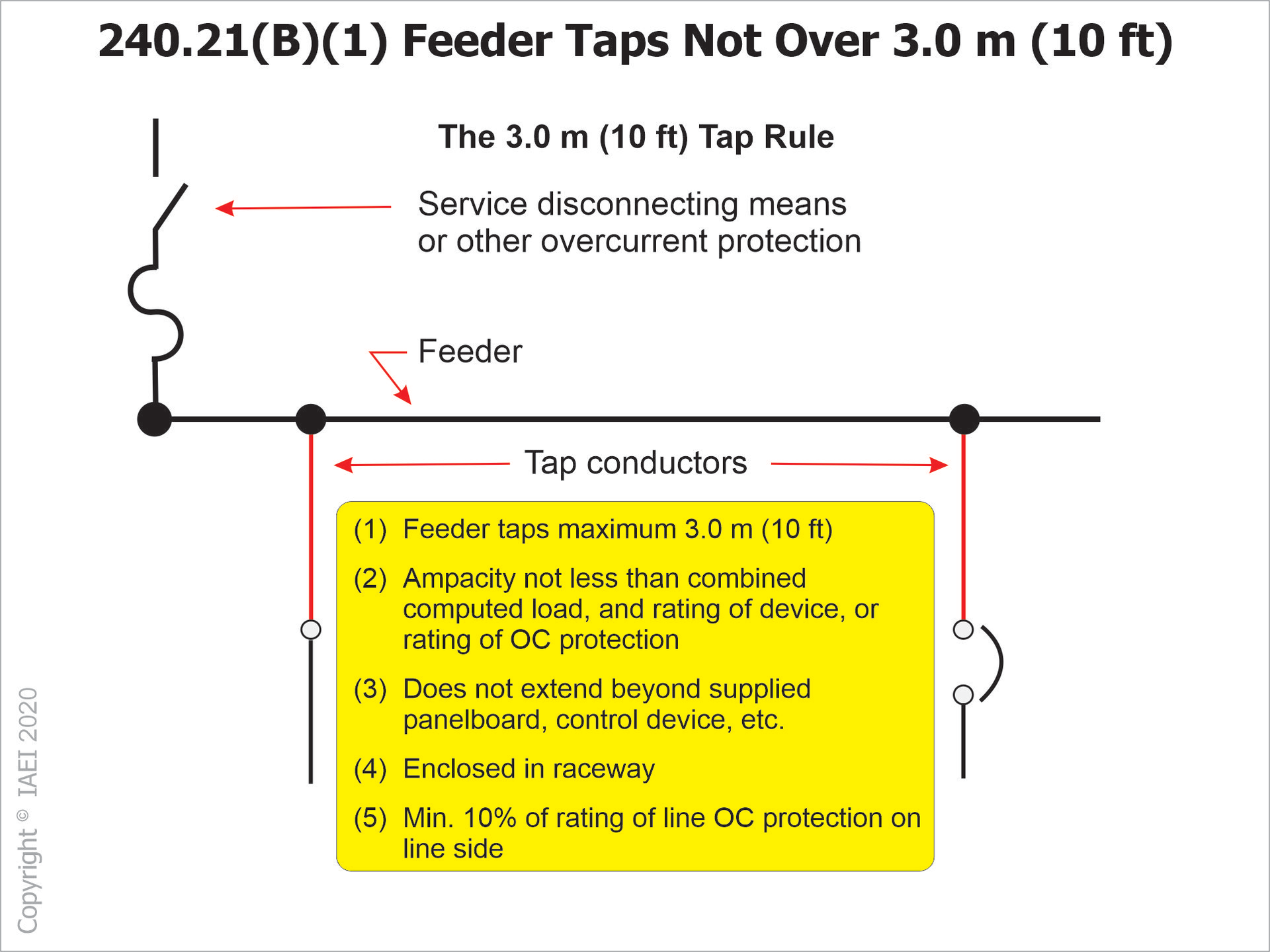

Electrical installers are typically involved with taps that are 10 ft or less in length or more than 10 ft but not exceeding 25 ft in length. In some cases, such as outdoor settings, taps are permitted in longer lengths. So, what’s the deal with the distance limitation, and why is the distance important?
The length of the tap, along with the size of the tap conductor, are major factors in determining the overall impedance of the tap conductor. Why? The tap conductor is generally smaller than the feeder conductor from which it is tapped. When applying the 10-ft tap rule (Fig. 1), the tap conductor may be as small as one-tenth the size of the overcurrent device protecting the feeder from which the tap is made [Sec. 240.21(B)(1)(4)]. When applying the 25-ft tap rule (Fig. 2), the tap conductor may be as small as one-third the size of the overcurrent device protecting the feeder from which the tap is made [Sec. 240.21(B)(2)(1)].

Where is the ground-fault short-circuit protection for the tap? The OCPD is protecting the feeder ahead of the tap. If the impedance of the feeder (and the potentially much smaller tap conductor) is too great, the feeder and its tap will not carry enough current with a fault on the tap conductors to open the overcurrent device upstream that protects both the feeder and the tap conductors. In short, the reason for the size — one-tenth on the 10-ft tap rule and one-third on the 25-ft tap rule — is that these limitations have been demonstrated as sufficient conductor size and length to carry enough current to open the upstream feeder overcurrent device providing the necessary ground-fault/short-circuit protection of the circuit in the event of a fault on the tap conductor.
Now that we’ve addressed ground-fault and short-circuit protection, we are left with the final component of overload protection for the tap conductor. Overload protection is provided at the termination of the tap, which is often a fusible switch in a main breaker-type panelboard that is not greater than the ampacity of the tap conductor.
