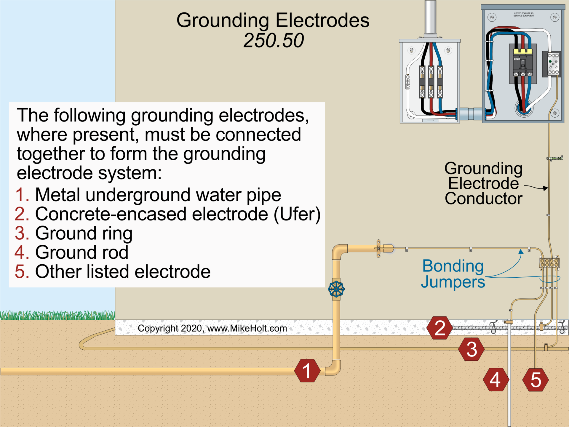

To create a grounding electrode system, you bond the various electrodes that are present. By “electrodes,” we mean those described in Sec. 250.52(A)(1) through (A)(7) [Fig. 1].
Of course, you can’t bond something like conductive steel reinforcing bars that are inaccessible without chipping up the concrete, so there’s an exception for that [Sec. 250.68(A), Exception No. 1].

Most errors with grounding electrode systems result from designing or installing the system without a clear overview of the components and how they should interconnect to provide a path to ground. To get this clear overview, draw out the system.
Old-timers often sketch it out by hand on a sheet of paper. This isn’t because of a lack of computer skills, but because this method forces you to think it out as you go. Draw the electrodes first, and then draw the bonding jumpers that connect them. Ensure each electrode is one of the eight types in Sec. 250.52(A) and that each bonding jumper complies with Sec. 250.53(C).
