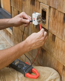

During the recent 2020 Code review process, panel members of the National Electrical Code (NEC) approved changes to ground fault circuit interrupter (GFCI) protection. The changes are meant to reduce the dangers associated with electrical hazard and shock. The most significant change is the increase of amp protection ratings across all receptacle outlets (both indoor and outdoor) wherever GFCI protection is required.
Some of these updates apply to long-standing Code requirements. As such, there may be a need for additional clarification down the road. For now, let’s look at how some of these changes will impact the work electrical professionals currently perform for their customers.
GFCI language expansion
The 2020 change: Code-making panel 2 (CMP 2) updated the text to read, “All 125V through 250V receptacles installed in the locations specified in 210.8(A) (1) through (11) and supplied by single-phase branch circuits rated 150V or less to ground shall have ground fault circuit interrupter protection for personnel.”
In layman’s terms, the NEC removed amp values across all amp-rated receptacle outlets requiring GFCI protection in the areas listed in this section.
