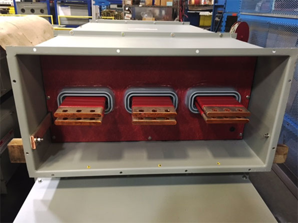

This photo shows a typical medium-voltage metal enclosed bus duct section prior to installation.
In industrial facilities, it is common to have bus duct or cable bus supplying power from the secondary side of a transformer to switchgear at the 4,160V and 13.8kV levels. But it’s a common mistake on the design engineer’s part to utilize the secondary conductor rules found in Art. 240 for voltage levels above 1,000V.
