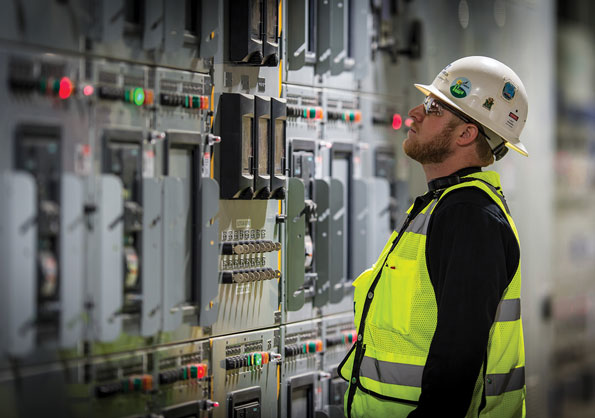

Photo 1. This panel is just one of many operator interfaces for the large interconnected electrical power production source at this facility. A Black
