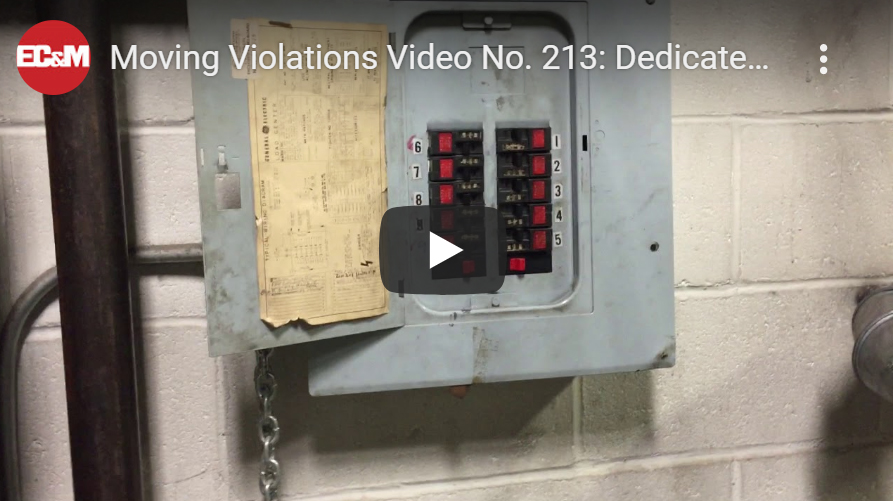

In this video, Russ shows us an all too common situation found in the field.
In this video, Russ shows us an all too common situation found in the field. Although it’s clearly an older installation, the copper water lines and gas lines running below this electrical panel are a clear violation of the dedicated work space requirements outlined in the National Electrical Code. These pipes also violate the working space requirements of Sec. 110.26(A).
