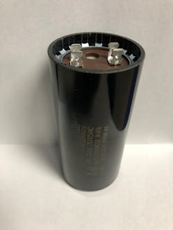

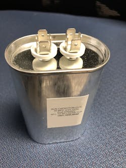

Single-phase motors, adjustable-speed drives (ASDs), and power factor (PF) correction applications often depend on capacitors to operate properly. This article explains how to test these critical components for electric motors in general, as well as for specific use applications like motor starting and PF correction (see Photo 1 and Photo 2).

For capacitors rated 600V or less, discharge any residual capacitance by connecting a 15 to 20 kilohms resistor rated 5W or greater across the two capacitor terminals for at least 10 sec. Verify that the voltage has decayed to zero by connecting a DC voltmeter to the capacitor terminals. If there is a residual charge, then the voltage will gradually decay as the meter discharges the capacitor. For capacitors rated above 600V, check with the capacitor manufacturer for the proper test procedure. Before proceeding to test a capacitor, disconnect any leads connected to its terminals.
