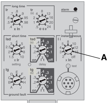

Many years ago, I responded to an outage at a hospital. I determined the ground fault setting on the 4,000A main was set to 100A (0.1 sec), as shown in the Photo below. This was the factory minimum setting for this device. Since the downstream loads were fused, a short to ground in a 10-hp motor caused the 4,000A main to open on ground fault. The electrician reclosed the main to restore power. It tripped a second time on ground fault. Again, the coordination study determined the proper setting to be 1,000A with a delay of 0.5 seconds.
With the proper settings installed, the breaker feeding the motor would have tripped, and the outage would be limited to the one motor — leaving the rest of the facility with power. In addition, the investigating electrician would know where to look for the problem equipment.
Why is this breaker tripping?
Breakers are set to a minimum when they leave the factory. The reason is if there is a fault during construction, the breaker will trip, and there will be less stress to the system components (e.g., breakers, cables, and connections). After construction is complete, the breaker settings should be adjusted according to the coordination study in preparation for occupancy. In more than one instance, the electrician decided to increase the settings to maximum. In general, this is not recommended. Increasing the settings of a protective device can create a bigger problem: an increased arc flash hazard.

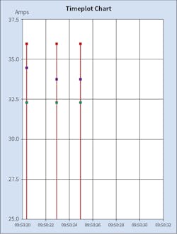

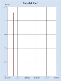

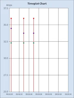

When a transfer switch transfers an inductive load (e.g., motor or a transformer), it can produce a large transient current — the result of part cycle saturation of the magnetic core of the transformer. As a result, inrush current could be mistaken for short-circuit current, causing the breaker to trip. Several factors affect the magnitude of the inrush: system impedance, magnetizing resistance, and winding resistance. As illustrated in Fig. 1, the transformer inrush was approximately 36A during the first three times the breaker was closed. The fourth time the inrush was recorded at 140A (Fig. 2).
when the primary winding of a transformer is suddenly connected to an AC voltage source at the exact moment in time when the instantaneous voltage is closer to its peak value, the inrush is low. On the other hand, if at the exact moment in time the instantaneous voltage is closer to the zero crossing the inrush is substantially higher. This would explain why it did not trip during the other transfers. Considering the instantaneous setting on this breaker is set to a minimum, there will be times when the breaker will trip and other times when it won’t.
