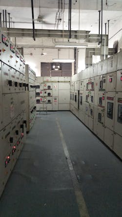

Transferring loads, manipulating circuit breakers, and turning equipment on and off are tasks that can be found within normal day-to-day operation. Any interaction with electrical equipment should involve hazard identification, assessment, and mitigation (Photo 1). One critical question that should always be answered before interacting with electrical equipment is: “Is this equipment operating within normal operating conditions?” In addition: “Is the procedure the safest possible available means to accomplish the work?” It seems like it never fails that after an occurrence someone determines there was a safer means available.
All work where the potential for injury exists should include a written procedure that addresses mitigation of all potential hazards. Considering the complexity of today’s electrical power generation and distribution systems and Internet access to manufacturer’s documentation, there is no valid reason not to be familiar with the system. To understand “normal operating condition,” you must understand the requirements in NFPA 70E, Standard for Electrical Safety in the Workplace.

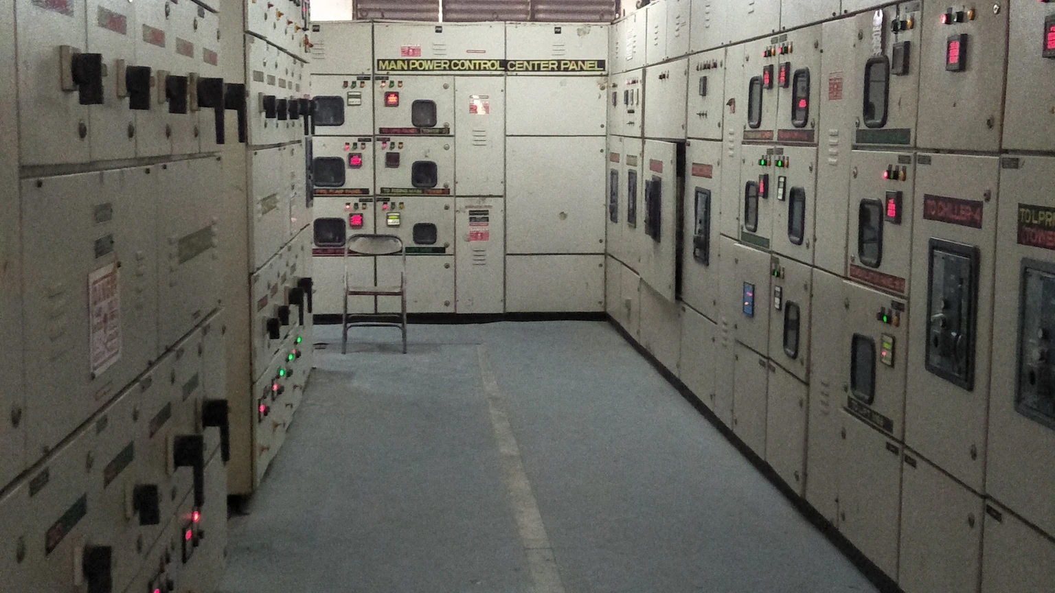

Properly maintaining equipment is a must unless we are willing to place equipment reliability and employee safety in jeopardy. Equipment manufacturers will include instructions with the equipment purchased. These instructions normally contain important information such as equipment operation, alarm recognition, technical specifications, and maintenance actions/intervals. If the maintenance actions are not completed at the intervals set forth by the manufacturer (at minimum), then the equipment must be considered not to be within normal operating condition. See Photo 2Photo 3, and Photo 4 for examples of the consequences of poor maintenance protocols. Reference NFPA 70E Sec. 205.3 and NFPA 70B, Recommended Practice for Electrical Equipment Maintenance, for further information on the maintaining of electrical equipment.
