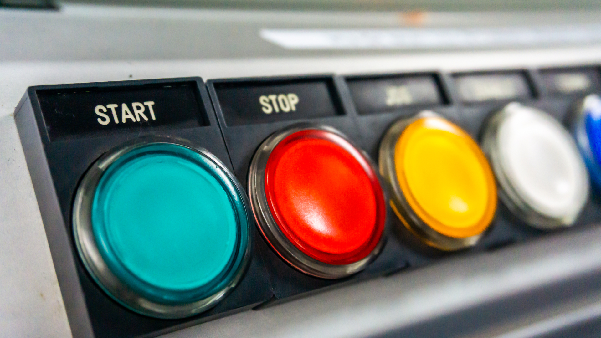

You arrive and ask the operator to show you what he means. The operator’s control screen functions, so clearly there is power to the system. You ask the operator what should happen when he taps the START button onscreen.
He does that and various pilot lights come on. Then he points to one end and says, “Parts come in here, through these hoppers.” He motions along the machine, describing what each section should do. “And out this end, you get the finished piece. But as you can see, no parts are coming in, and this conveyor isn’t moving even if they did.”

If the machine checks out, next turn your attention to the operator controls. Determine which input(s) and outputs should change at the PLC when the operator pushes START.
