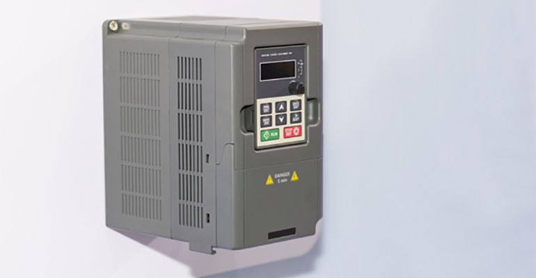

Is your VFD motor branch circuit properly protected?
Industrial facilities commonly use variable-frequency drives (VFDs) to control the speed at which alternating current motors operate. Let’s examine a couple of typical scenarios commonly encountered when designing the branch-circuit short-circuit and ground-fault protection device for a low-voltage (460V, 3-phase) motor branch circuit that includes power conversion equipment (VFD).
