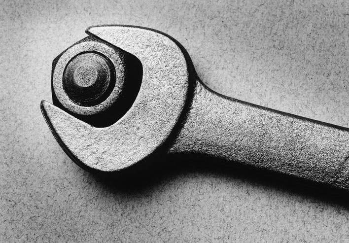

• Manually testing connection tightness. Some people think it’s a good idea for the PM to include the task “Tighten connection if loose.” This is typically interpreted as “Put a wrench on the connection and force it a little tighter.” What normally happens is a perfectly good connection goes bad due to overtorqueing. One (expensive) solution is to replace all the hardware and make a new connection. A more practical solution, if you can get the downtime approved and don’t mind all the lockout/tagout hassle, is to use a resistance tester across each connection. Infrared thermography is usually your best “connection checker.”
