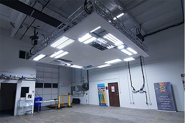

Researchers at Pacific Northwest National Laboratory anonymously ordered two samples each of seven luminaires – five identified through their LED Lighting Facts listings, and two found through an online search. All of the products were industrial luminaires with correlated color temperatures (CCTs) of 5000K, and all but one had exposed LED emitters.
The results of photometric testing of the samples were compared with the manufacturer-claimed values and samples were also tested for horizontal illuminance, flicker and maximum luminance.
Among their findings, researchers said photometric tests yielded values that were reasonably close to the manufacturers’ claims, with actual lumen output varying from the claims by no more than 9.6%, and actual power draw by no more than 6.8%, while power factors were all above 90%.
When installed in a high-bay space, all of the luminaires produced a fairly even light distribution across the workplane, with a maximum-to-minimum illuminance ratio below 1.7 at a 37-inch standing desk height, the researchers said. But when a group of 23 “knowledgeable observers” were brought in to judge aspects like comfort, they threw a spotlight on the problem of glare.
“Only two of the luminaires received acceptable ratings for visual comfort and overall quality, and those had either diffusing lenses or reflector optics engineered to cut off the view of the bare LEDs above a fixed viewing angle. The two top-rated luminaires received acceptable ratings in categories of light distribution, shadows, and color, in addition to visual comfort. The least-preferred luminaires corresponded to the three that received the most negative comments about glare,” said the report’s summary.
