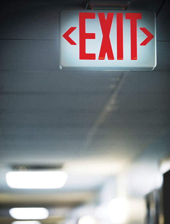

The regulations for security and egress lighting shutoff have changed considerably in the new version of the standard (kimwhit92/iStock/Thinkstock).

(2) Security and egress lighting shutoff [§130.1(c)]
The regulations for security and egress lighting shutoff have changed considerably in this new version of the standard. Under the 2008 standard, most buildings had a lighting allowance of 0.3 WSF for security and egress purposes at all times. The 2013 standard has a maximum security and egress lighting allowance of 0.2 WSF during normal business hours in a building (this lighting may remain energized even if the space is unoccupied during normal business hours). However, general and egress lighting must be shut off when unoccupied after regular business hours. To meet fire codes, the egress lighting must be responsive to occupants (it must turn ON automatically after hours), and the controls have to fail into a functioning state. As an exception, offices are allowed up to 0.05 WSF, for lighting during unoccupied periods, but only along emergency egress areas designated on the building plans.
Note that an egress lighting system provides enough illumination for occupants to safely leave a space under normal building operating circumstances. Emergency lighting provides a minimal amount of light for egress when the normal lighting system has failed.
This change in egress lighting doesn’t affect emergency lighting system requirements, but it does impact the way emergency lighting initiates the operation of battery packs and charges the batteries. A generator and transfer switch emergency lighting system may also have design impacts to consider.
