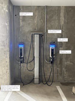

Two Level 2 chargers will be mounted on separate pedestals in front of their respective parking spaces. In other words, the EVSE will be considered fixed-in-place equipment. An example of Level 2 chargers in a parking garage is shown in Photo 1.
Typically, manufacturers will provide all the necessary EVSE, including the charger, output cable from the charger to the EV charging connector, the EV charging connector, and the pedestal and mounting accessories. When determining the output cable from the charger to the EV, Sec. 625.17(B) states that the cable shall be type EV, EVJ, EVE, EVJE, EVT, or EVJT flexible cable.
Photo 2 shows the output cable from the chargers in Photo 1. NEC Table 400.4 provides more details about the cable type, including cable size, insulation thickness/type, and usage. The overall cord length, per Sec. 625.17(C), cannot exceed 25 feet without a cable management system. As such, for this case study, a 25-foot cable will be specified; however, to keep the EVSE looking clean, a cable management system (e.g., cable retractor) will also be included.
