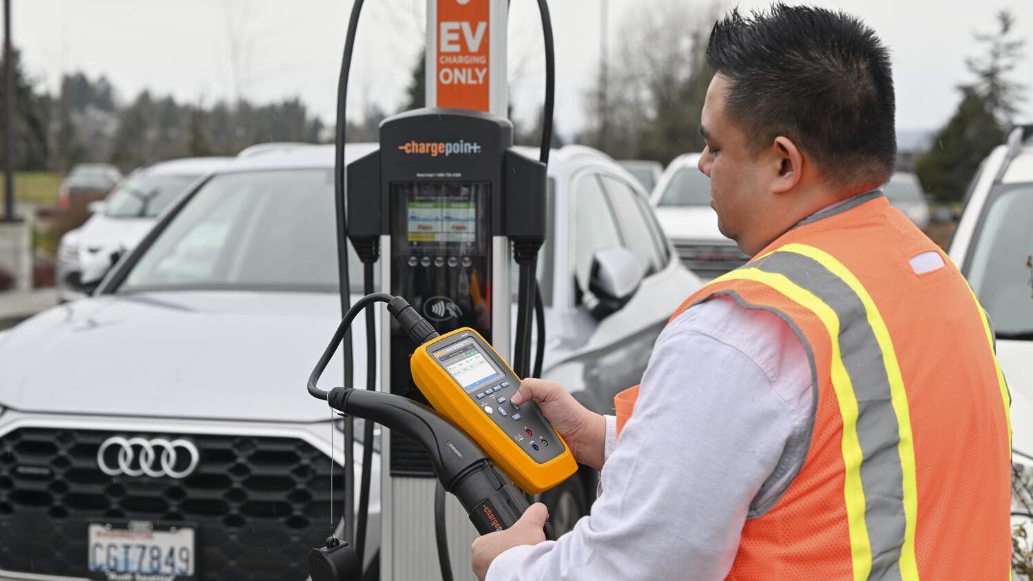

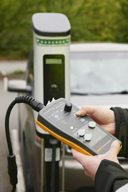

Selecting the right tools for the job
Choosing the right tools for maintaining EV charging stations is critical to ensuring safety, efficiency, and reliability. Given the complexity of these systems, maintenance teams need equipment that not only identifies faults but also supports comprehensive safety and performance testing. Here’s what to consider when selecting tools for the job:
  • Functionality and versatility: Look for tools that offer a wide range of diagnostic capabilities. The tool should be able to test several aspects of the charging station, including voltage levels, ground fault detection, and communication between the charger and the vehicle. Versatility ensures that a single tool can handle multiple tasks, reducing the need for additional equipment.
  • Ease of use: Given current labor shortages and the influx of less experienced technicians, it’s important to select user-friendly tools. Test equipment that requires minimal training yet delivers accurate and reliable results can help maintenance teams stay productive while reducing the risk of human error.
  • Safety features: Safety should always be a top priority when working with high-voltage equipment. Tools equipped with built-in safety features (such as protective earth testing and automatic shutdown in the event of a fault) can help prevent accidents and protect workers from potential hazards.
  • Durability and reliability: Maintenance tools are an investment, so durability is key. Reliable tools reduce the likelihood of productivity loss, ensuring that maintenance work can proceed without interruption. Choose tools that are built to withstand the tough conditions of fieldwork, including exposure to weather, dust, and rough handling.
  • Support and training: Finally, consider the availability of technical support and training resources. Tools backed by comprehensive customer service, tutorials, and support networks can make a significant difference in how quickly your team can get up to speed and resolve any confusion that may arise.
By carefully selecting tools based on these considerations, maintenance teams can ensure they are equipped to keep EV charging stations operating safely and efficiently. The right tools not only enhance the quality of maintenance but also contribute to overall operational uptime and customer satisfaction.
