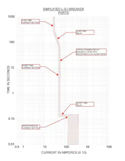

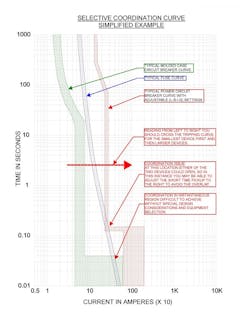

Selective Coordination
Selective coordination is defined in the NEC as “the localization of an overcurrent condition to restrict outages to the circuit or equipment affected, accomplished by the selection and installation of overcurrent protective devices and their ratings or settings for the full range of available overcurrent, from overload to the maximum available fault current, and for the full range of overcurrent protective device opening times associated with those overcurrents.” In other words, the overcurrent devices in an electrical system should ideally be designed to open the device closest to the fault or event. This helps to prevent nuisance trips of unaffected portions of the system, which could lead to facility downtime. For example, if a fault on a 20A branch circuit trips a 1,200A main breaker, a large portion of a building/facility would experience a preventable power loss. To get a distribution system to operate in this manner, you need to compare and contrast the electrical characteristics of each overcurrent device in the system.
Selective coordination is required per the NEC on emergency and legally required standby systems. It is not required on other portions of the electrical distribution systems in the building. However, its implementation is recommended. Typically, when selective coordination is not required by code — but is implemented regardless — it is not implemented to the full range of overcurrents. Coordination in the instantaneous range is difficult to achieve due to the inherent breaker properties. Typically, coordination in this range requires special design considerations and often involves upsizing of equipment or the use of adjustable electronic trip circuit breakers.
To perform proper coordination studies, the exact electrical distribution system equipment needs to be known. Every breaker and fuse have different properties and react differently. In addition, installed feeder routing can alter the impedance contribution of the wiring. Basis-of-design equipment can be used preliminarily to provide a working solution for bidding purposes. However, a final study will need to be performed once final equipment is selected.

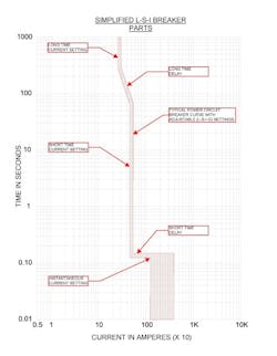

See Fig. 1 and Fig. 2  for an example of time/current curves and an explanation of how they work together.
