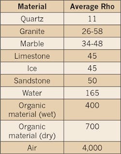

Average Rho values for some soil constituents and materials, as written in “Behavior of Moist Soils in a Thermal Energy Field” by Hans F. Winterkorn, Princeton University.
Typically, soil’s thermal properties are expressed in terms of thermal resistivity (which is the inverse of thermal conductivity) — better known as its Rho value. For electrical duct banks, lower values of Rho are desired for the surrounding soil and concrete encasement materials. Lower Rho values allow the heat generated from the cables to dissipate farther away. This results in lower changes in temperature throughout the soil. Soils with higher Rho values will not dissipate the generated heat as effectively and will insulate the cables, causing the heat energy to build up closer to the cables and reduce their allowable operating ampacity. If the surrounding soil is especially dry (or susceptible to drying out quickly), the possibility of a “thermal runaway” increases, resulting in worst-case soil conditions. Refer to the Table for a reference to the average Rho values of various materials.
