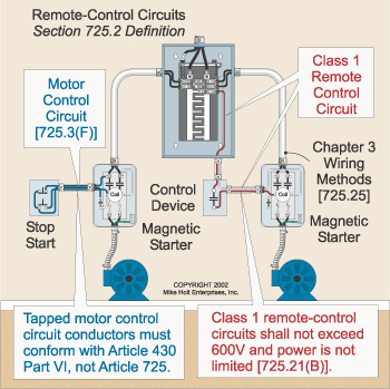

The Code also implies in 430.72(A) that motor control circuits tapped from a motor branch-circuit, short-circuit, and ground-fault protective device (usually fuses or a breaker) need not be protected per the requirements of 725.23 because these circuits aren't considered to be Class 1 circuits and the requirements of Art. 725 don't apply (Fig 1.). Conversely, motor control circuits served by an external power source and those derived from the secondary side of a control power transformer are classified as either Class 1 remote-control and signaling circuits or power-limited Class 1 circuits, and the requirements of Art. 725 apply.

One common misconception among many installers is that it's acceptable to route Class 1 circuits with other power circuits. After all, this basic concept is outlined in the requirements of 300.3(C)(1). However, the requirements of 725.26 don't allow you to install Class 1 circuit conductors in the same raceway, cable, or enclosure with power circuits unless they're functionally associated (Fig. 2). A change in the 2002 NEC (725.26) also prohibits the placement of Class 1 circuits in a cable tray with power conductors that aren't functionally associated. You should only combine systems that are functionally associated in their application in a common cable tray.
